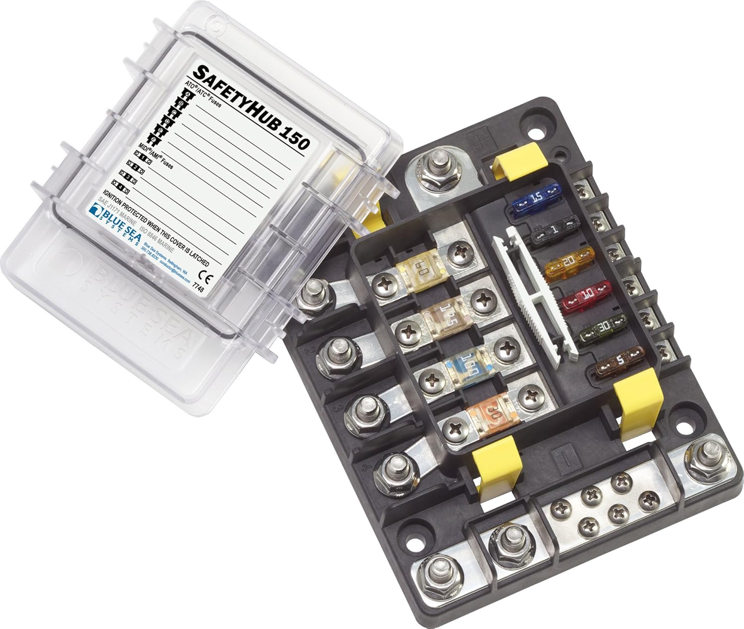

Don't want to try and spend anymore money but I'm wondering if I should just buy a block like this and do the entire setup on this one block:
4 Circuit (Higher AMP components)
IGN - 30A MIDI/AMI Fuse
RAD FAN - 30A MIDI/AMI Fuse
45A FL - 40A MIDI/AMI Fuse
75A FL - 70A MIDI/AMI Fuse
6 Circuit (Lower AMP components)
P WINDOW - 25A
RH LAMP - 20A
LH LAMP - 20A
AUDIO - 15A
ALT S. - 7.5A
EGI - 7.5A
This is all well in theory, however, this setup still requires me to find a place to add a 15A fuse for my oil cooler fan. I just want to do this as cleanly and safe as possible. If anyone has any completely different ideas, please chime in. I am definitely no wiring master and can use all the help I can get.
