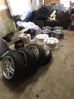

Sold my xt7s(I hate myself still) and picked up some more 17s. Some model 5s as you saw. Decide to go 17 all the way around

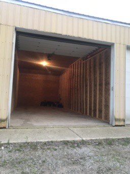

Me an my brother decided to go halfsies on a small storage space. 16x38’ with shitty lights, no heat and 110 sockets for electrical. But more ideal then being outside fixing things.

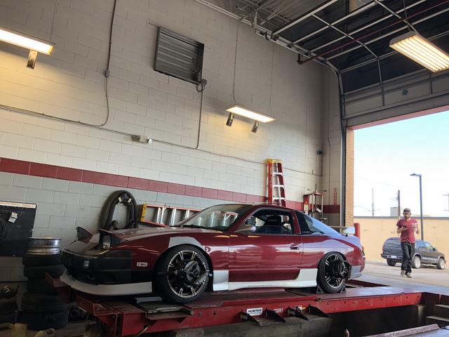

So, I raised(ugh) the front of the car and aligned it.

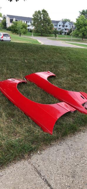

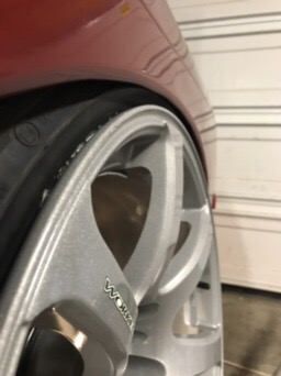

My car was insured but no plate. I had a bunch of fun doing a little streeting and eventually tire caught the fender after I lowered it because I didn’t like how it sat haha. This is the reason I got rid of the rcc kit. It pushes your wheels out 25mm so it works better for wheels that aren’t as low of offset and if you don’t have your car very low. Bought some decently clean fenders for $100 from a guy in kzoo.

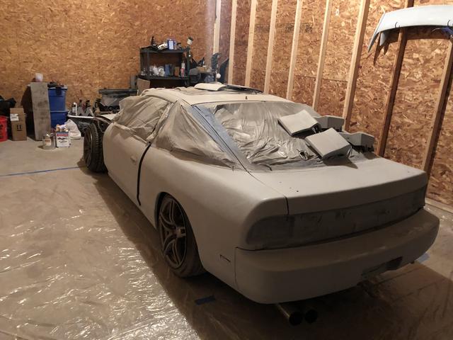

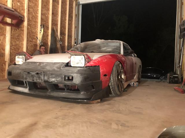

After fighting with the car, I knew that it was going to stay in there until I painted which was quite the endeavor. I decided to learn how to do it, I asked people on the internet a bunch of questions, red a lot of things but ultimately, I had no one that could stop me from making mistakes. So I prepped, sanded, sanded, sanded, sanded, you guys get it. Deleted the third brake light and shaved the antenna.
Bought some origin cf canards(for sale)

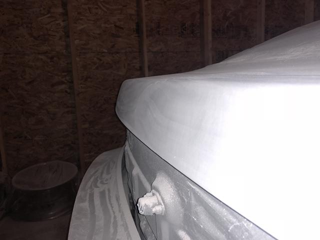

Took everything back apart to prime the car fully with polyester filler to get everything somewhat straight and then block it, shoot urethane primer and wetsand it.
Cut the passenger side rocker out about a foot section to make it better then what I did in the past.
Prepped the kit and all that jazz in a day or two. I also bought this air compressor being it was the biggest that I could safely run in my “shop”.
