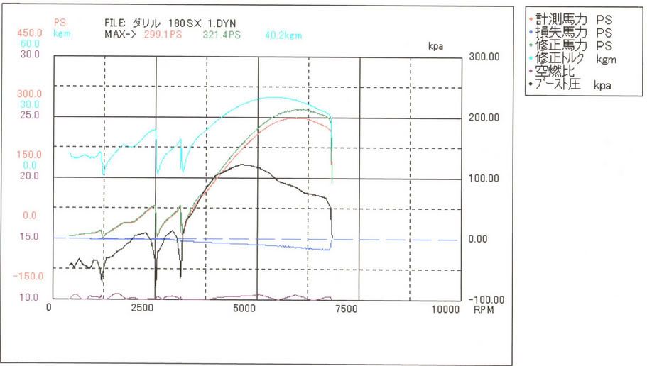

Put the 180 on the Dyno and
Well hit the Dyno today. Was hoping for 280 and got a little better. If it wasn't so damn hot and humid I could have a couple more I think, it was at 1400 in the afternoon. I tuned it myself with an SAFC II and Wideband.
Mods are:
HKS acuated S14 T28
Aftermarket Exhaust from and including the Manifold Back
Z32 MAFS with APEXi Intake
Tomei Cams, Gears, and Headgasket
Greddy Manual Boost Controller
Walbro 255, Nismo 550cc Injectors, Nismo FPR, SAFC II for fuel
Greddy Type S BOV
Some other shit I don't need to name
You can see where my boost drops. I was told it is due to the Manual Boost controller and I need to get an Electronic one. Also my Speed cut hit at 180klms. So yeah I need a Power FC. Once I post up pics and Vid you will see the Contraption they hooked up to my exhaust it was crazy, made the car absolutely silent.
