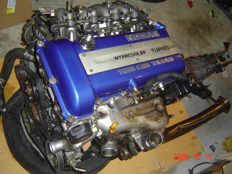

Hey everyone,
All I have to say is WOW, this site has A LOT of information been fun sifting through everything, but now I feel the need to post up my plans hehehe.
I know this can be covered in a simple search, but I feel every person has different goals and needs, wants, financial abilities etc, so just wanted to hear some of your opinions. I bought my 2nd S13 coupe 2 months ago and the original owner had a SR20det that was from his wrecked hatchback ready to install into the coupe, plans didnt go through so he sold me the motor, the car and a whole wack of parts.
My GOAL is to have a completely reliable track car, run 13s 1/4 mile all day long without me taking massive downtime to repair stuff. Shooting for roughly 300rwhp or more. I currently have a brand new GT28R for the SR20, but I was thinking of upgrading to a GT2871R. Looking to run 12-14psi on the 28R and 10-12psi on the 2871R.
Currently the SR20 has:
94 SR20DET Blacktop
-75,000kms on it
-replaced turbo gaskets/hoses
-centerforce dual-friction clutch 1000kms
-modified aluminium radiator
-custom FMIC
-custom hotpipe/cold pipe
-new belts
-BOV
-Walbaro fuel pump
-Megasquirt custom Standalone system
I have already bought:
-Megan exhaust manifold
-Megan 3" downpipe
-Megan Racing pulleys
-Megan 3" Turboback exhaust
-Greddy Aluminum oil pan
I KNOW I need, but haven't bought yet:
-Nismo Motor/tranny mounts
-Nismo Thermostat
My BIGGEST concern would be the headgasket, SHOULD I replace it?
Should I get a Nismo FPR?
Should I upgrade my stock 370cc injectors?
Should I upgrade from GT28R to GT2871R?
Is there anything I'm missing?
I want to do as much as I can while the motor is out before I put it in, save me time/money later on. I'm not going to cheap out, but i'm not made of money either , Also I have no immedient rush to get it going.
Let me know what you guys think, sorry for the long post! Its my first one
Heres a picture! I'm excited can't you tell????

- no MAF I'm assuming means you're going MAP?
- what happened to 14psi? why 20 pounds all of a sudden. 14 is just about right for a daily imo.
- cams later on will mean another re-tune.
When is all this happening? Keep us posted.
Old 12-01-2006, 10:21 PM   #20
Tom Ngan
Tom Ngan's Avatar
Location: x
Posts: 102
Tom Ngan has a spectacular aura aboutTom Ngan has a spectacular aura aboutTom Ngan has a spectacular aura aboutTom Ngan has a spectacular aura aboutTom Ngan has a spectacular aura aboutTom Ngan has a spectacular aura about
I'm slowly amassing all the parts for the engine right now. I have no real deadline for it to be finished, but I'd like to have it in my car, tuned, ready for some track runs by summer time.
Currently I have a Accord as my daily driver and the insurance doesn't expire til April, so that'll be the deadline
I'll probably do 14PSI on the 71R w/ ARP studs, 1.5mm HG with 600cc+ injectors.... If I feel the need to i'll get it tuned up to 18PSI or so and that'll be my dyno pull and my track days....
Keep you guys posted

Originally Posted by fliprayzin240sx
WTF? I wanna see anybody actually try to bump SR fuel pressure pass 55 psi on stock 370s and tell me what happens. Nubies dont need to start giving advice on shiet they dont know first hand.
I was deliberately being absurd there to show how undersized the injectors are, not suggesting that was actually a good idea to run that sort of fuel pressure.
14 psi on the GT2871R .64 depending on what else you got to support it, should get you roughly 280 whp. For a reference, these turbos doesnt start to liven up till you go pass roughly 14 psi. The jump in hp from 14 to 18-20 psi is amazing....thats why to me, you must as well tune it for daily driving on street gas to as much as you can...20 psi or bust. You can always crank down the boost with a controller having too much power to you is an issue.
