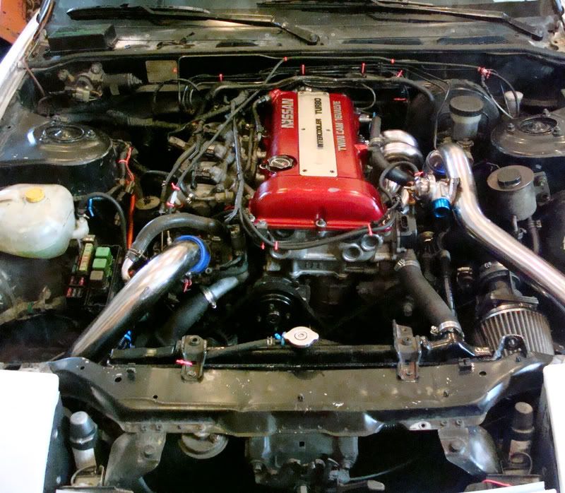

It wasnt the timing.. a vacuum line wasnt properly hooked up!!
i do have a new problem.
the car starts and runs however under acceleration it moves sluggishly and the turbo makes a funny noise.. and she is also overboosting at 20psi.. i recently replaced the stock turbo with another, because the old one was toast!! i was wondering if anyone had a diagram or steps on how to put in boost lines properly.. maybe i missed something. my charcoal canister, my oil catch can is deleted, got rid of the recirculation on the BOV, and the make shift boost controller.. enclosed is a pic so you can see if their is anything missing.. can anyone help??
i should mention that i bought the car already swapped and this is why im probably having so many problems.. my friend and i decided to take out the motor when we replaced the turbo.. some things had to be re-wired such as the starter grounds, checked the new clutch, tranny and drive shaft.. all is good there.. but it was just a hack job of a swap and i bought it.. lucky me.... this pic is our result of the swap after we were done..
( this is before i primed the turbo.. hence the CAS unplugged and no fuse..)
