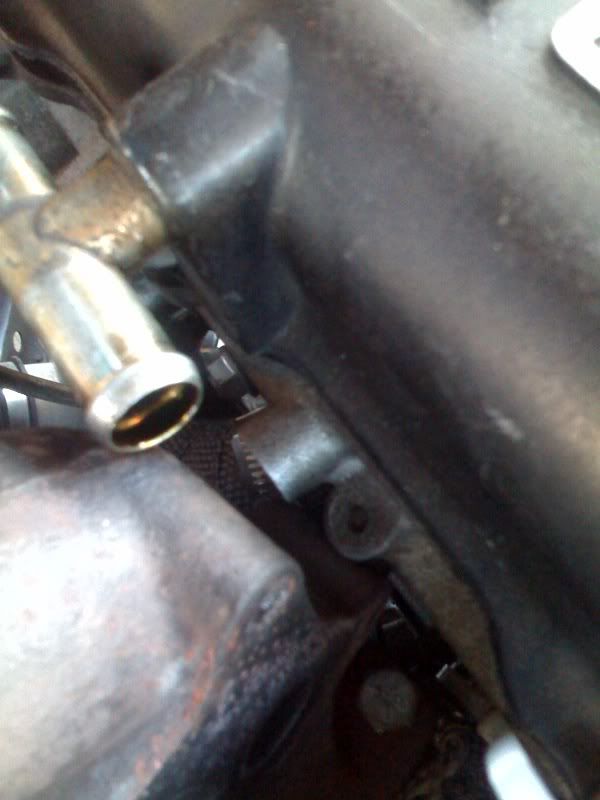

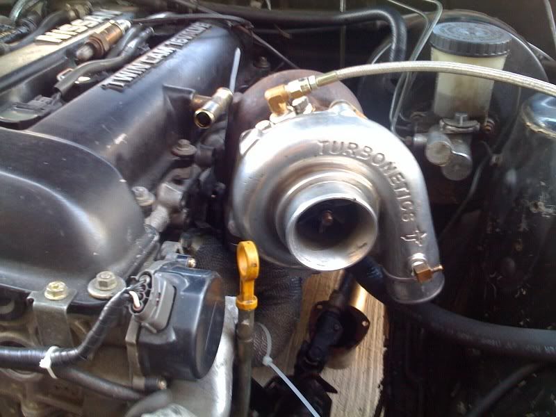

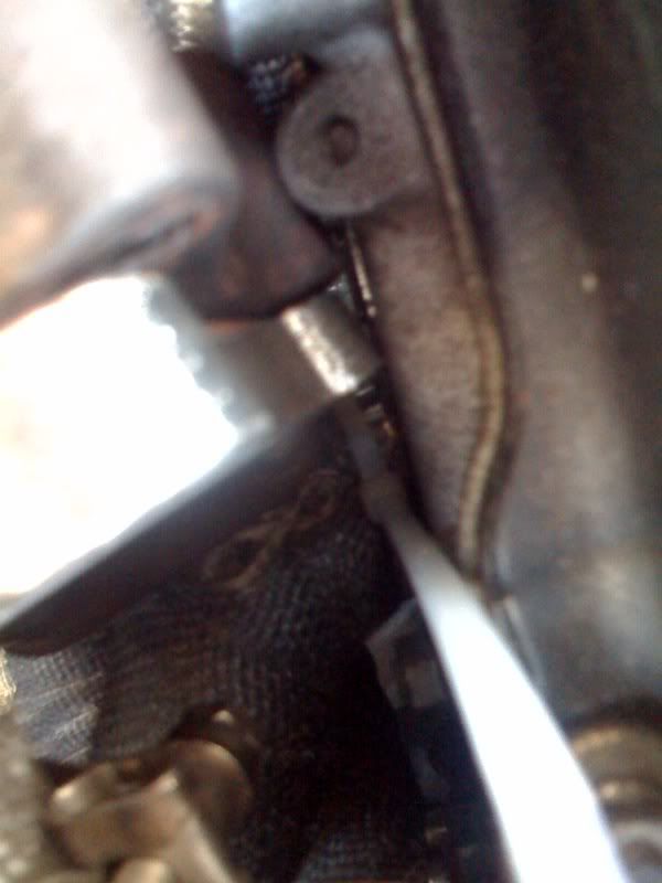

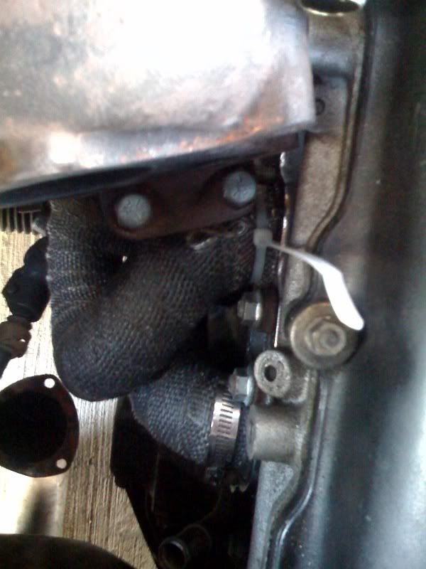

ok I got some pics
And with the down pipe held up to it
Sorry for the crappy pics I took it with my iPhone

Originally Posted by shmiddy View Post
ok I got some pics
fixed

well you have good BMC clearance.

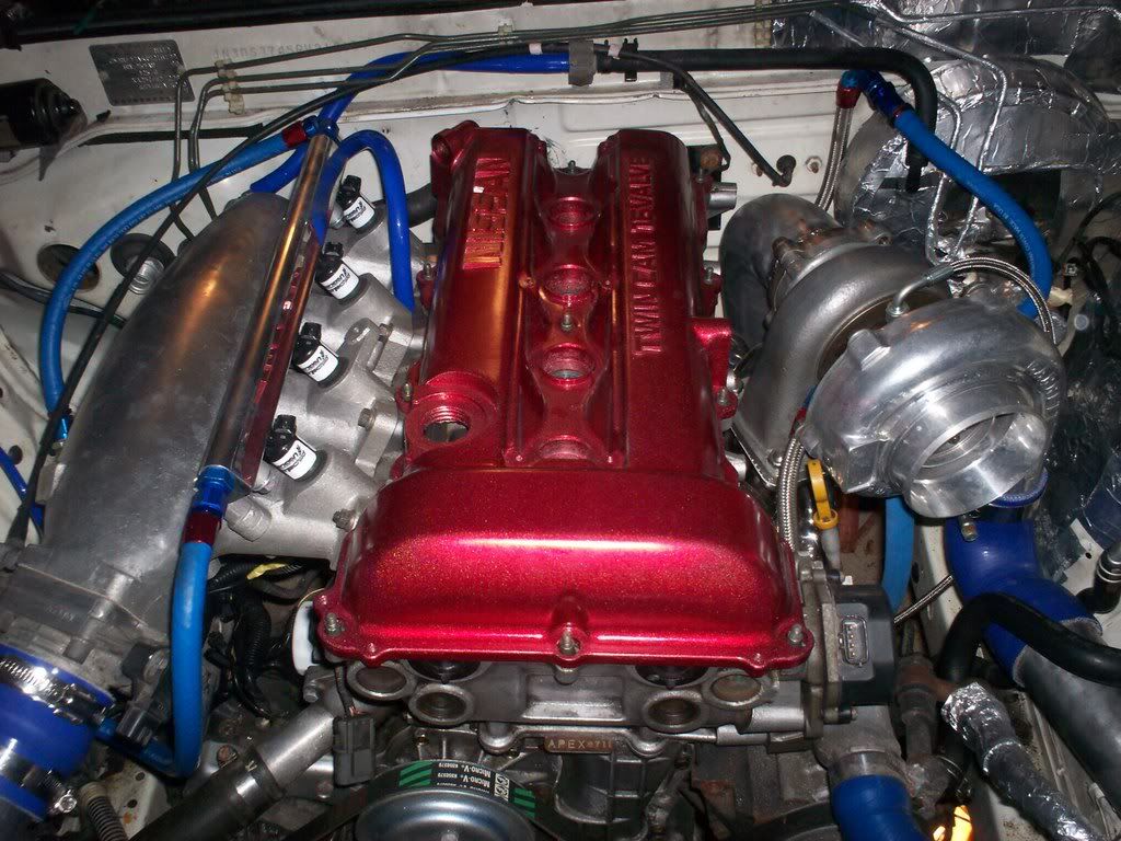

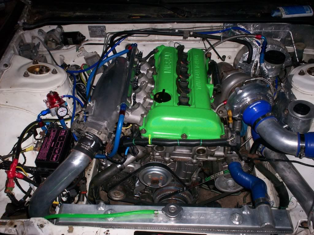

I actualy have this same manifold and i thinks its very fucking awesome quality for the price! Plus i had no problems at all! I just think your turbine housing is whacky!
heres some pics BTW Garrett gt3076r
rps13drift is offline   Reply With Quote
r u for real??? i dont understand?? that looks awsome.... do u think it can be my turbo housing?
oh btw i posted the wrong pic this is the pic of the manifold and the down pipe together.. notice how it sits so close to the head that i have no way of getting the furthest bolt on.. or am i just going ape shits?
my other option is to heat and twist slightly... i mean it only has to clear about a 1 inch or so.....

its not a "wacky" exhaust housing...its typical.
That tee fitting on the valve cover are just pressed in. you can take it out very simple (what you plug it up with is your idea/problem)
Just run a screwdriver through the tee and push down on one side, it'll break free and then you just wiggle it out.

Is that a 5 bolt exhaust housing on the turbonetics turbo in those pics? In the other two pictures they are running 4 bolt exhaust housings and there is a difference in size between a 5 bolt housing to a 4 bolt housing. That may be one of the reasons you are having fitment problems.
i was thinking the same thing ........

A number of manifolds only work with one type of turbine housing.
...e.g...the RevHard manifold for the KA. Similar situation as yours.
Sucks you didn't know earlier, but now you do - Swap to a turbo with a 4-bolt turbine, and you'll be set.
That's exactly what teh problem is. Ford 5-bolt style is HUGE compared to 4-bolt/v-band.
