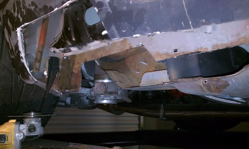

I noticed some serious rust under the passenger side quarter panel this morning, poked it with my finger, and everything fell apart. Ugh. Started cutting and it just gets worse. Rust keeps going past where I cut in the picture, but is getting less and less torward the front. The metal support with the holes in it is rusted through and basically fucked. The part that really worries me is the backside of the sheet metal is rusted as well. Seems like it'd be a lot harder to fix / get to?
I'll get more pictures later, but any ideas on tackling this? I'm decent with a mig welder, just not really sure where to start.

That's a lot of rot if those interior panels are also rusted up that badly. Any chance of getting some more pics?
I'm thinking you're surpassing just basic sheetmetal repair. Might want to visit a junkyard and cut up another car to get some donor metal. Just piece it back up with maybe some additional gussets.

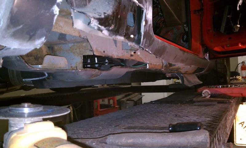

Started cutting into it more, but need more cut off wheels. *sigh*
So far, the more I remove, the worse it gets.

looks like you had a leak at one point ...
You are on the right track, all you can do is keep cutting, and as Def said, you could find clean panels from a donor car and patch them in, or you can just weld in metal to replace what you're cutting (it's just on the inside anyway) and then dose liberally with weld through zinc primer and por15 to keep it from rusting again.
Hope that helps, but it looks like you're in for some work there.
Good thing is, it's not the whole car, just localized.

Apparently, the quarter panel had been replaced there due to a crash. I'm thinking it was improperly fixed (understatement of the year). Also, it looks like there's a water hose coming from the sunroof that exits right there. fml
From the location, I think I'll be able to hide everything with a sideskirt so that's the plan at the moment. Can I pick up por15 at home depot / an auto parts store?

I guess you could just get the sheetmetal down to a common point and weld in a piece of 1.75 x 0.095" DOM tubing then cover with a side skirt. That would be at least as robust as the factory rocker.

Getting a little worried with how much I'm having to cut out. Oh well, the saga continues.
