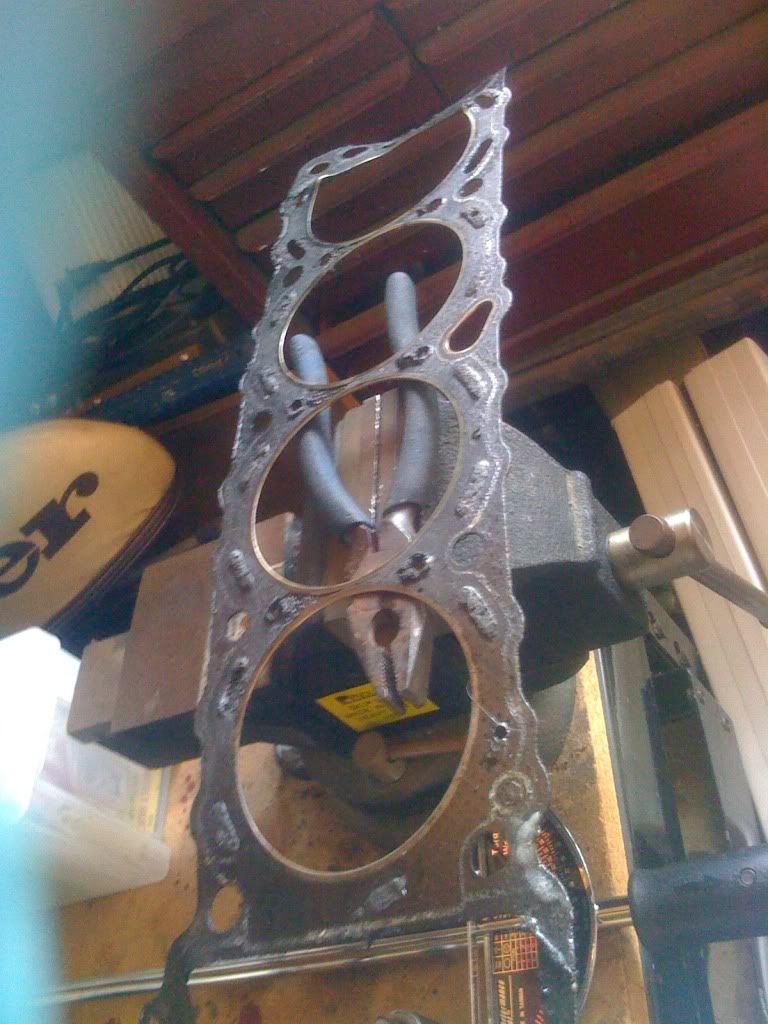

So I pop the hood, and of course there is smoke everywhere, and after popping my radiator cap off, it was a steam pipe for several minutes, being that there was no coolant for so long. so I proceed to pull my head and sure enough the head gasket is completely blown, looked like this:

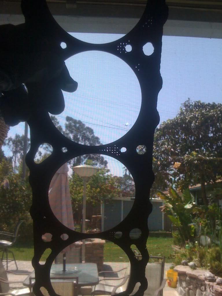

I bought a fel-pro intake gasket set, as well as head gasket. cleaned all of the coolant/oil combination off the tops od my cylinders. and cleaned out my intake manifold. I re-installed everything, torqueing every bolt to FSM specs and working slowly to make sure I did everything correctly. I installed a new knock sensor being that my old one was cracked and melting from the severe meltdown.

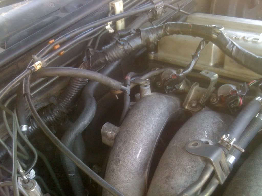

I also, for the sake of troubleshooting, simplified the EGR system and removed the plate with all of the hoses and sensors, leaving only a T. One end went to the tiny vacuum hose on the back of the intake manifold, to the FPR, and I T'd in the line that comes from the gas tank. Dunno if it's correct or not, to be honest... just went off my best judgement:
