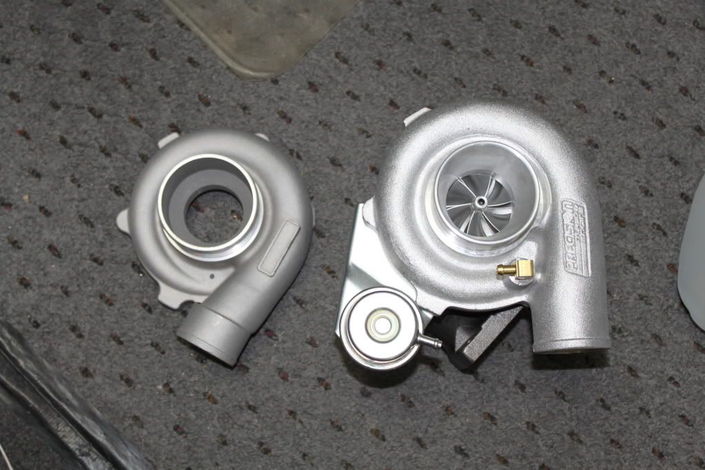

Guys interested in Precision turbos: Here is diff between B comp covers, pic inside
Hey guys, Just wanted to put this pic on here for anyone curious. When purchasing Precision's line of turbochargers, they offer a Garret comp housing or a Precision housing. They both utilize the same size inlet and discharge, but they are positioned slightly different. And this can be determined by the part number.
For example: A PTB205-5128 is a Precision style housing and a PTB225-5128 is a Garret style. A PTB305-5128 is a Precision E cover, which is larger then both. Below is a pic of the difference in the B covers.
[IMG][/IMG]
