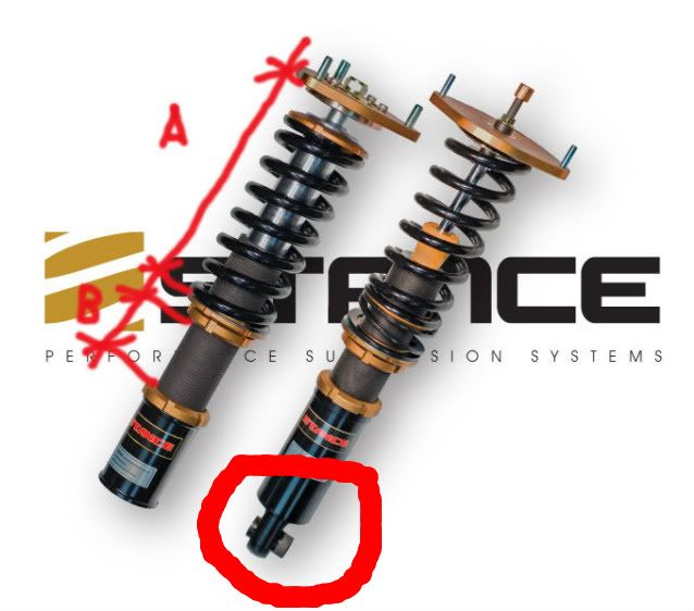

Not sure how to adjust the height? Here is how:
Many answers I have found are people who are saying that just lose the bottom collar (gold color below B), and turn the thread body (B). But in these two days of repeatedly adjusting the height, I found out this way might be a little problematic.
When only adjusting the thread body, it will change the height of the
whole coilver, which it will also change the ride height. However, at the end, you will find out that both rear coilovers are running on different height. It is because the weight distribuation at the back is different. I used the 6kg/mm spring rate and the difference between compressed height verse the uncompressed height to make an calculation, which in the results, the rear passenger side is approx. 800 lbs and the driver side is approx. 600lbs. This will give you a different compression rate when you racing on the track or driving on the street.
Therefore, I thought of another mathematical way to adjust it. Instead of only adjusting the height of the part B, I also adjust the height of A, which it is meant to acheive the same compression rate for both rear coilovers.
From below the camber plate to the silver plate on top of the thinner gold collar, I made couple measurements in A verses the ratio with the measurement in B. Based on the weight distribution, there is my current data:
(recorded when uncompressed, which means lifted up without wheel)
Passenger side A=10in, B=6.75in
Driver Side A=7.75in, B=6.75in
In theory, this should give you the same compression height/rate when the car is lowered, and they will give you the same height of 24.25in on stock rims from the fender wheel well to the group, which is no finger gap for both rear wheels.

Both Front A = 8in, B = .5in
This will get you 23.75in from the fender wheel well to the ground. About 5in from the ground to front nose.
The result (ride height) will change if you change any of the numbers (height of B or A), which means you might have to do anothe calculation. Again, this is my personal calculation, please use it as concerned. (This might be an absolutely unnecessary since I heard some people say don't touch the preload?) However, I have found out the ride has become a lot better/solid comparing to my initial adjustment when just adjusting the height of B without A. I'm assuming this is the reason why some people are complaining about coilovers' bouncy ride. Also, these data are calculated with the variables of helper spring which is at a different (linear) spring rate than 6kg/mm.
Questions 1:
When I remove the original rear damper, I found out the difference at the bottom where it holds the bolt. The stance one is thicker which seems the bolt won't go in as much as the thinner stock damper. Would this lead to an danger of unsecured bolt?

adjusting both point A and B changes ride height but before even installing the most crucial adjustment that should be very exact on both left/right side is the "A". that is what is called spring preload. its not necessarily the same for front/rear, that depends on weight(cross) distribution and spring rate too. Leaving "A" too loose means your spring has unnecessarily play and you'll get ALOT of clunking and general lack of traction over bumps. Too tight of "A" means your springs will bind and you may get inconsistency especially on the rebound.
"B" can be eye-balled roughly because it will require adjustment later once you install and let the coilover settle for a few days. ofcourse you cannot adjust it with the weight of the car on the coilover (DUH!) hehe.
To be honest get exact as possible because you will never know if you got it right as long as you are not a suspension guru and dont have a roadcourse to test it on.

In respond to your first question, I understand what you are saying. The top most gold collar is sometimes impossible to adjustment due to lack of room inside the wheel well. However, in my experience, all you have to do is to loosen the very bottom gold collar (below B), then turn the thread body clockwise to lower the height, and counter-clockwise to increase. Remember to keep the middle two gold collars locked, so your spring height (A) won't get affected. Lastly, I don't think it is necessary to lossen the up nut on top of the pillow ball.
As for preload, it is correct with two whole turn (approx 2mm). However, it is always depending on how knowledgable you are about driving and car components. Indeed, Stance has made it adjustable, I'm sure it is meant to be adjusted in certain condition. In my experience, I hand tightened the spring until i feel force, then i make the two whole turn with the spanner wrench.

I need some help with my stance GR+ coilovers. I recently purchased a IS350, and it came with Stance GR+ coilovers, but the ride is sitting too low in the back, it rubs anytime i good over the smallest bumps. So I would like to adjust the ride height and while im at it I would also like to make it smoother (only in the rear). Now, Im a complete nembie with suspension or coilovers, but I have been doing a lot of research on different forums. I have a good idea of how to make adjustments, but before I touch my car I want to be absolutely certain of what I am doing, so please let me know if this is correct:
First, Im going to adjust for damping by rotating collar A counter-clockwise, im not sure how many revolutions I should do, so I'll do 2 complete revolutions and see how that rides. After I will rotate collar B counter-clockwise untill its very tightly sitting under collar A. Thats all for damping correct?
Second, I would like to adjust the ride height. Here I'm going to rotate collar C counter-clockwise untill its lose. After I will grab the entire threaded body and rotate counter-clockwise, which will spin up and out of the base of the coilover. I want to lift the car up half-an-inch, so I'll rotate 3-whole revolutions and see how that turns out. Does the process sound correct, for damping and height adjustment?

To answer your questions... Well, forget about pretty much everything I said above. It's very much misleading when I look back now.
To adjust your ride height:
1) loosen the two collars between the coil (A) and the thread body (B).

I have a question about the rears, is there a wrong way to install them? I couldn't find any instructions as to which side the bottom portion of the strut should be mounted. If you look at it closely one side of the strut the rubber insert is thicker than the other, so which side faces in toward the car and which one faces out towards the wheel.
I included a picture just incase, the part in question is circled in red
[IMG][/IMG]
