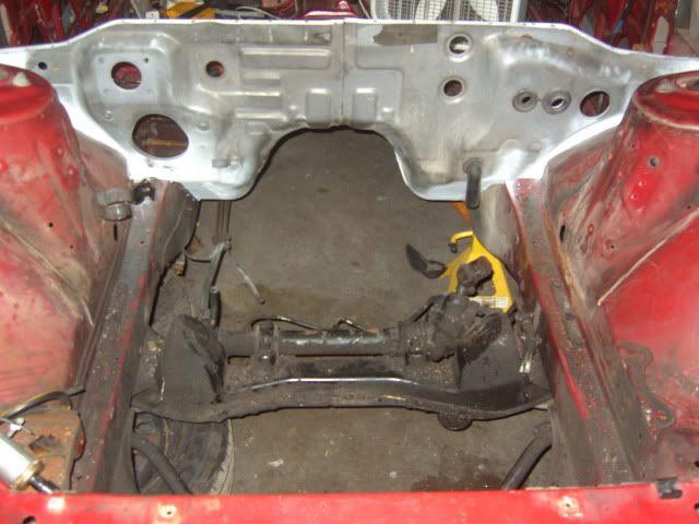

ok so i started my rhd today removed the engine and the whole wiring harness, dash and 2 front seats..everything is going smooth taking my time and doing things right no cutting corners so i wont have to do extra work at the end.. cutting and welding tomorrow i should start posting pics by tomorrow
ima start posting the steps....
1. remove engine swap (meaning harness, ecu, motor, tranny)
2.remove all the wiring from firewall with fuse boxes
3. remove dash to get the rest of the harness
4.remove seats
5.remove center arm rest
6. remove carpet
7. measure (multiple times)
thats how far ive gotten in the first day i will start adding steps IM DOING IN MY RHD! (im not responsible if by following MY steps you fuck shit up so dont blame me) will add all the steps when im done

Done properly:
Firewall removed (no cutting)
Who the hell stole the firewall ?
Going back together:
Z28ricer is offline   Reply With Quote
