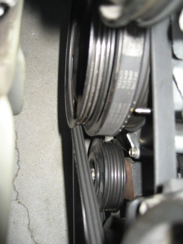

crank pulley set at tdc.

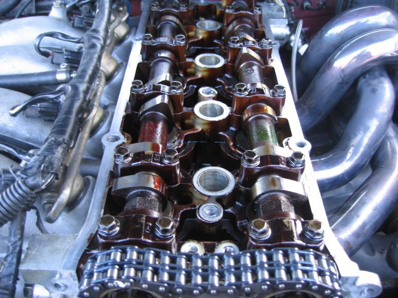

cam lobes facing outward.

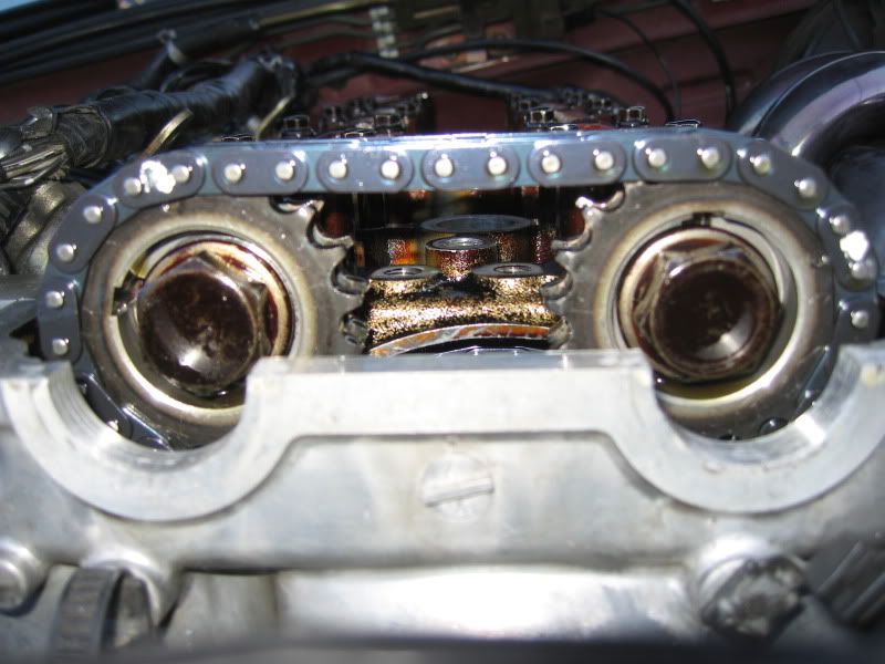

timing chain marks lined up with cam sprocket marks.

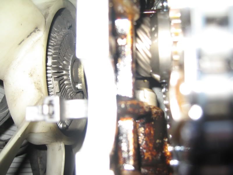

cant really see it but silver chain link lined up with mark on idle sprocket.

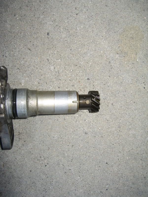

distributor marks lined up before putting it in.
cant really see it but how the dizzy marks look when inserted.
