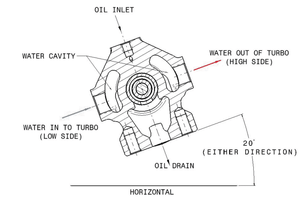

The turbo water feed from the block should go to the lower water port on the turbo, the one that faces the engine. The oil from the turbo comes out the higher port on the other side and up to the water neck. This promotes "thermal siphoning". The DIF lines are a pain to install with this proper orientation, but it is possible. They designed them the other way around which isn't efficient.
This is according to Garrett:
https://www.garrettmotion.com/racing...or-your-turbo/

yeah thats pretty much how my t25 is setup my diftech water line goes to the turbos water port(facing the engine). The water feed from the sr20s block I have setup to the side of the turbo facing the strut tower and the oil feed and drain you obviously can only install one way. I also run Kinugawa turbo lines and they work very well you dont even need to unscrew the turbos banjos from the block just undo the line and bam your done!

So you confirmed exactly what I said in my previous post, your water lines are hooked up backwards.
The feed line from the block goes to the lower water port on the turbo (facing the engine) and the return from the turbo (higher side towards the strut tower) goes to the upper water neck.

Yea..its not the true proper setup. But its not gonna destroy a turbo or an engine....it will run just fine
