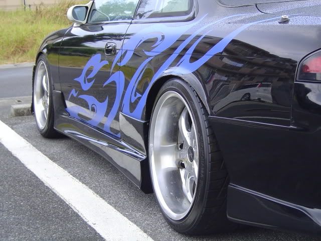

your car is still WAY too high. Lower it some more, then fitting those wheels will get a lot easier.

u know ur suppose to make exact duplicate flares... if ur gonna do it that way.

I'm talking about the rears. If you 're going to fit wheels like that on the rear, the lip should be no more than 2 fingers away from the lip of the stock wheel well arch. And 4 fingers for the front isn't that low either.
