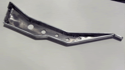

Ok, so I have been doing allot of Aluminum work at work lately and I was thinking of building some parts.
Here is the prototype for my Silvia S13 headlight bracket.
Main construction is 6061 aluminum 1/8in. by 1in. The feild is 1/16in.
I still have to drill mounting holes and such, I was also thinking of enlarging the holes in the feild. They are very light and stiffer than OEM, I also plan on making rights and lefts.
Let me know what you guys think.

Old 03-17-2006, 11:35 PM   #2
andrewmp6
Location: kentucky
Posts: 376
andrewmp6 can only hope to improve
nice make a few and do a group buy

Old 03-18-2006, 01:54 AM   #3
Fibercus
Join Date: Jul 2001
Location: Canyon Country, CA
Posts: 714
Fibercus is on a distinguished road
Send a message via AIM to Fibercus
Very nice.
Poll to see what other common parts member would buy perhaps. Im sure theres quite a few.

Old 03-18-2006, 02:13 AM   #4
CrappyS13
Location: San Jose
Posts: 342
CrappyS13 is making a name for him/her selfCrappyS13 is making a name for him/her self
very very nice...much better than what i have done...how much are you looking to sell for? Think about if it is worth your time cause when you think about it, the stock ones go for 50-70 bucks so if you group buy it at like 45 + s&H i think you can do quite well. whats it take 20 mins each?

Old 03-18-2006, 11:16 AM   #7
2iv0 sx
2iv0 sx's Avatar
Location: Lng Bch Calfna
Posts: 1,442
2iv0 sx has a reputation beyond repute2iv0 sx has a reputation beyond repute2iv0 sx has a reputation beyond repute2iv0 sx has a reputation beyond repute2iv0 sx has a reputation beyond repute2iv0 sx has a reputation beyond repute2iv0 sx has a reputation beyond repute2iv0 sx has a reputation beyond repute2iv0 sx has a reputation beyond repute2iv0 sx has a reputation beyond repute2iv0 sx has a reputation beyond repute
fit test them...

Old 03-18-2006, 11:28 AM   #8
nissan90sileighty
Location: nj
Posts: 80
nissan90sileighty is an unknown quantity at this point
i like em, looks good... i agree with 2ivosx give them a test fit once u get them right i wouldnt mind havin a pair

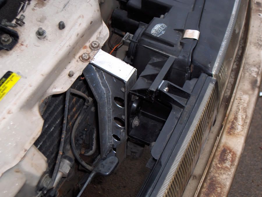

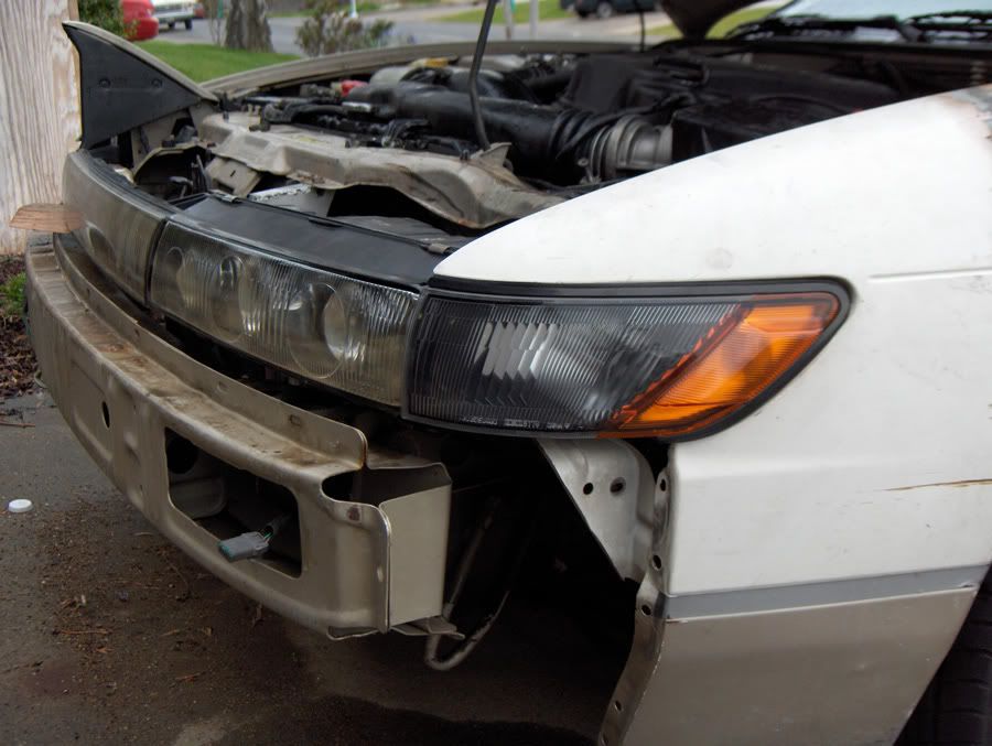

I have an update on my custom brackets. I did a test fit today...in the rain. This is what they look like bolted up.
Please excuse the fact that I am not ready to fully do my Silvia conversion, so I was unable to bolt the bumper up yet. There will be some minor refinements to the design, but this is how they will look for the most part.
Please feel free to give me your input on these.
Thanks guys

Old 03-24-2006, 09:52 PM   #19
Irukandji
Join Date: Jul 2004
Location: Compton
Posts: 4,268
Wow that's some awesome fabrication. Nice work, fits like a glove.

Old 03-25-2006, 12:05 AM   #20
koukidough
koukidough's Avatar
Location: Long Beach, California
Posts: 399
koukidough is an unknown quantity at this point
wow that thing looks more sturdy than the car chassis itself. Great job!

Old 03-25-2006, 12:42 AM   #21
NemeGuero
No more nissan.
NemeGuero's Avatar
Location: RAIN, Washington.
Posts: 8,132
yah mang.. shit looks sturdy as all hell.. straight too.

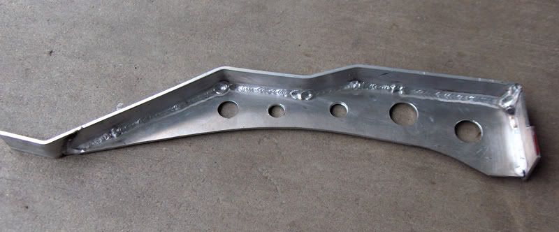

Ok so far feedback has been great...Thanks guys. I am working on the second prototype now to be shipped to the test pilot early next week. Here is a pic of version 2.0
In version 2.0 I used a slightly thicker material for the spine, but eliminated the back web. It turned out to be lighter, and alot easier to weld. It is also way stiffer than OEM.
I am looking into doing a group buy soon if everything pans out.

Old 03-31-2006, 12:19 AM   #26
2iv0 sx
2iv0 sx's Avatar
Posts: 1,442
are you goin to drill in the holes for the screws once you start selling? =D

Old 03-31-2006, 12:34 AM   #27
Jonnie Fraz
Premium Member
Jonnie Fraz's Avatar
Location: Cali
Age: 56
Posts: 1,371
Trader Rating: (29)
Jonnie Fraz is close to perfectionJonnie Fraz is close to perfectionJonnie Fraz is close to perfectionJonnie Fraz is close to perfectionJonnie Fraz is close to perfectionJonnie Fraz is close to perfectionJonnie Fraz is close to perfectionJonnie Fraz is close to perfectionJonnie Fraz is close to perfectionJonnie Fraz is close to perfectionJonnie Fraz is close to perfection
Feedback Score: 29 reviews
Send a message via AIM to Jonnie Fraz
Good question...the answer is yes, Actually I am putting in nut inserts instead of just threading the bracket. I will have pics of finished brackets up tomorrow. All holes are drilled including the holes for the horn wire tie downs, and the rubber bumper on top.
