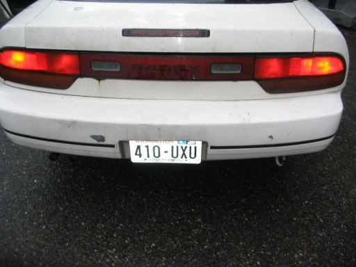

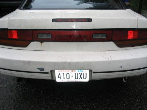

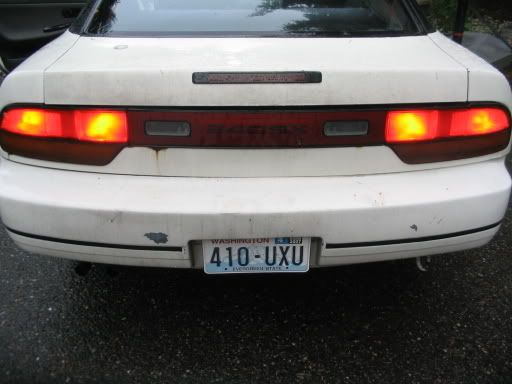

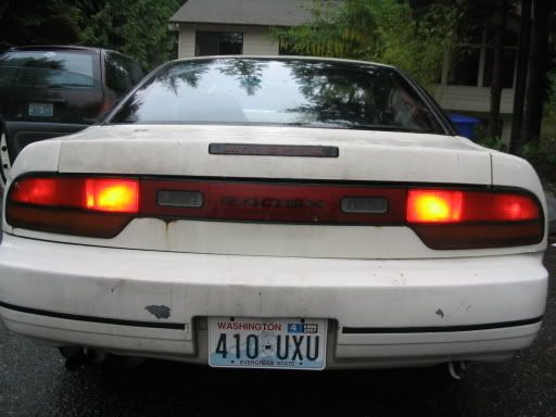

so heres some pix and more info to help out
lights off no braking: ( no lighting )
lights off braking: ( only outside lights )
lights on no braking: ( lights on, outside dim inners bright )
lights on braking: ( everyting lit up )

The inner lights should work the same as the outer lights. Your outer lights are working correctly from what I can see.
Did you recently rewire the taillights? It looks like you have the wiring wrong for the inner bulbs. I think you hooked up the brake signal to the wrong filament, and I don't think you hooked up your parking signal at all.
Looking vertically at the inner taillight harnesses on both sides, it should go Red/Blue for parking, Red/Green for braking, and Black for ground. Check that first. Most likely you have it backward on your body harness.
I also noticed that your center brake light doesn't work. Check that before you get a ticket.
