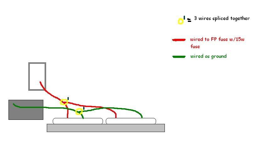

dont need no relays. wire them together then split the power in 2 and use 2 fuses on acc a 20 and 15 amp in the kicker panel fuse box on the driver side. so 35 amp total. there u go on with ignition and cools like a mofo. ground to the battery.

the way i posted it will never disconnect or fail. if it blows a fuse there will be a back up haha. so ur will never be without a fan on

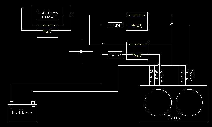

Ok, so after reading the HSW page on relays, i think i get it.
I use a relay on each positive wire on the fan, connecting the electromagnet part to the fuel pump. This will allow the fuel pump to send a tiny bit of electricity to my relay, telling my fans to turn on. I then hardwire the relay to a power source (i assume i can just wire it straight to the battery) and ground it at a common engine ground.
right?

heres mine. my paint skills suck haha

Yeah. Go back to wootwoots link. There are links to examples using the Bosch relay and it will show which pins to use. You can get those relays just about anywhere (NAPA, PepBoys, ect) and they're cheap. The wire that goes across the relay contacts and then on to power the fans needs to be #12 sized wire. I would fuse it too (30amp). The wire from the fuel pump relay that controls your new relays can be something smaller since it probably takes less than an amp to operate.

sorry to be retarded, but where should i put this 30amp fuse?
should i get 4 and put them after each relay?

...but, since you are using one signal (from the fuel pump relay) to fire all 4 relays at once, you could just put the pairs together and have one relay for each fan. Having 4 would make sense if you were going to contol them separately (or plan to later) but it sounds like you just want them both on high as long as the f pump is runnig.

yes sir that is correct, i bought 2 relays since that's all advance auto parts had at the time, and i was gonna pick up 2 more after their next truck comes (tomorrow afternoon) but i guess i'll just use the 2.

Guys...I WOULD NOT wire these fans directly to the fusebox...use relays.
E-fans require too much amperage to route through tiny fuse box wiring. Do the same thing as the diagrams are saying, but use the wires coming form the fusebox to activate the relays, not power the fans.

I completely agree with Orion. If I remember correctly, these fans draw something like 20-30 amps, which is way too much additional amperage to try to pull off the fuse box (or the accessory wiring). Use the Fuel Pump Relay to control two fan relays. Make sure the power for the fans is drawn directly from the battery through appropriately sized fuses and a relay that can be controlled by the Fuel Pump Relay. If you wire it like the schematic below, the fans will be powered from the battery, and will be turned on whenever the fuel pump is on. Wire the coils of the two new relays to the coil of the fuel pump relay. If wired like this, if one of your fuses blows, you will still have the other fan. Also, fuses are rated in Amps, not Watts like in some of the above drawings.

nbrindley: Nice schematic. Are the fans 20-30a each or 20-30a total?
Yeas it is! Thanks NB (...you CAD geek : ) )
Are the fans 20-30a each or 20-30a total? I was curious as to their amp draw...
Each. Just one of my alti fans blew a 20amp fuse. Use 30s.
Also, the thing about adding on to an existing fuse is: even if you swapped a 15A fuse with a 30A, you have to assume the wire feeding that fuse only has enough ampacity to carry the 15A it was originally intended for. For 15A you need #18 wire. If you put 30A over #18 it could potentially burn the wire itself before it blew the 30A fuse you stuck in there.

ok, i used your diagram actually, but my wiring for high power is like this:
Yellow and Black=Ground
Blue and Green=Power
Anyhow, I have one last question. Where do I get the Fuel Pump + signal from? I found the fuel pump fuse in the kick panel. That is the only labeled Fuel Pump anything i can find. I know this sounds stupid but it's the last thing i need to know. Everything else is ready to be wired up now.

Hot damn. I can't get my shit going. I tried wiring it up my way, and obviously it didn't work. When i tested them spliced the way i did, only 1 came on. Im still super confused about all that wiring and crap.
Times like these i wish i was a elec. nerd. how about some actual photo guys?
Since im reversing my AC fans, i should ground the positive, and route the negative to the battery. On that negative line, i should splice, connect to a relay, then a fuse, then to the FP?
