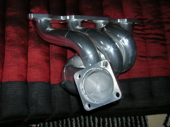

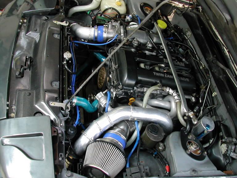

All those manifolds (Megan, SSAutochrome, XSPower) are all made by the same companies in China. It's kind of a crap shoot. Some people have had REALLY bad luck with them cracking prematurely. My two brothers & myself have all used them with zero problems though. I had mine Jet-Hot ceramic coated & it's helped keep my underhood temps down drastically compared to just running the stainless manifold, as well as not rusting over the past 2 years of use. I believe that most of the people who have problems with them are from not properly supporting their exhaust system, as well as whacking their exhausts into things from being too low, etc. Here's what mine looked like with ceramic coating when new, and after two years of use.

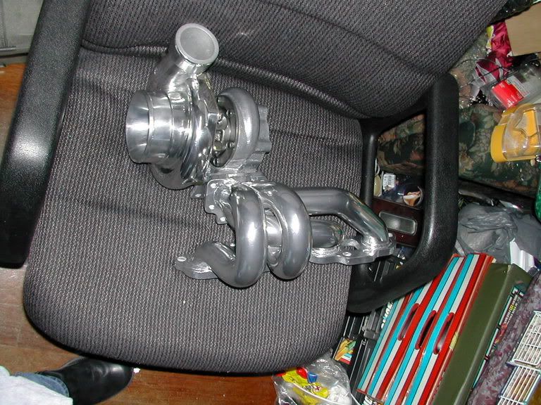

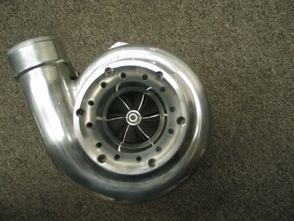

I'm in the middle of upgrading, however my new goal is 500 RWHP at under 1.4 boost. Here's the manifold & turbo I'm using.
Greddy T78 manifold
Full-Race GT3567R
I had to change the mounting flange on the manifold & send it out to Jet-Hot to get ceramic coated. The GT3567R I ordered from Full-Race is based on the Garrett GT35R (aka GT3540R) modified with Full-Race's T-67 compressor, which really isn't a T67 but similar to a T-04R. It's very new to the market, but is capable of supporting 700 RWHP with the exact same spoolup as a GT35R!!! For a GOOD 400 RWHP top mount setup, I'd go with the GT30R for quick spool. Or you can save a load of cash with a non-ball bearing type.

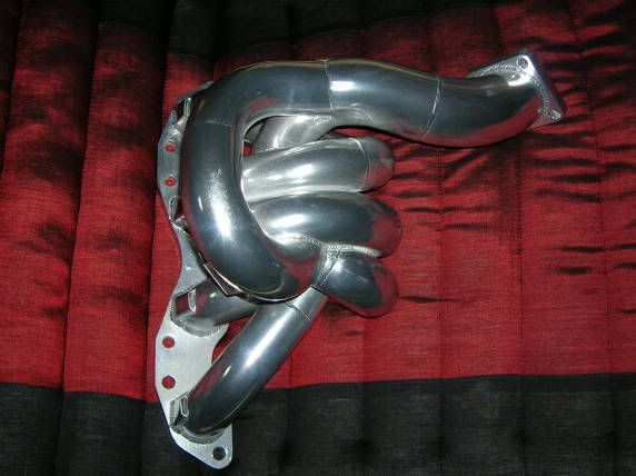

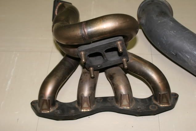

Greddy manifold after Jet-Hot coating inside and out

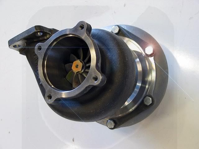

My 3567R waiting to go onto my new engine...
Shooting for 600 rwhp...we'll see how it turns out...
