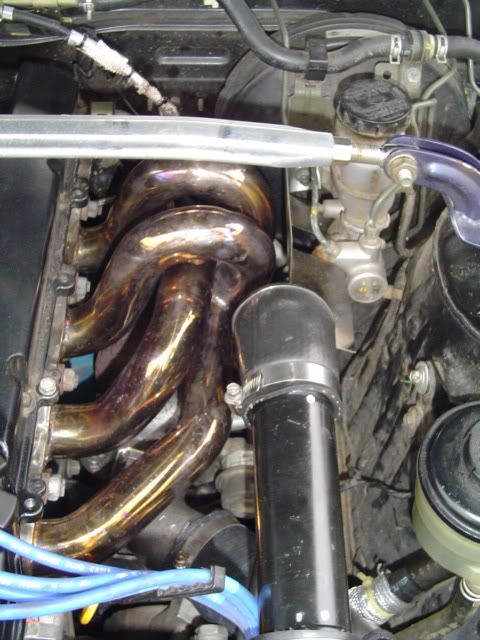

So just like the title says, I have a problem. I just installed my HKS (yes its real) SSQV on my s14 KA-t. Previously I was running a stock Evo VIII bov resurc. and I had absolutely no compressor surge. After the SSQV was installed I can't hear anything other than compressor surge....WTF.
If anyone can shed some light on my situation I would greatly appreciate it.
Brandon
note: it is also set as loose as it can go...meaning no adjustment screw

i was pretty sure that SSQV's came preset with the right adjustment...

well that would solve that if that is right.

adjusting the bolt on the back side of the BOV changes its response

Are you sure you hooked it up to the correct vaccum signal? If you have a vaccum pump, check if the valve even opens when vaccum is applied to it. At the least, push on the rubber section in the front with something dull to see if you can get the valve to open.
Compressor surge really is awesome. No hesitation between shifts either. If anyone has a spare T25 for sale, let me know.

If I push on the rubber part it goes in. I did try sucking air thru the vacuum tip and I heard air coming thru...like sucking thru a straw...shouldn't it want to build pressure? IE not hear air when vacuum is applied.

If you have the new SSQV, like I do, then you are going to have comp surge. I have it up until around 2psi, then boost above 2psi, doesn't have any surge. I still can't figure out why they didn't put a adjustment screw on the back of the new ones. I'd almost say re-sell it, and buy an older one, at least they have an adjustment.

you can do this, not just because i did it but because it may help your situation:
remove the whole SSQV from the hotpipe (or whatever), and disassemble it. then take out the metal cap that the adjustment screw pushes against, and reassemble. this will reduce some of the preload on the valve, beyond what the adjustment screw will do for you. There will still be enough force from the spring to create a tight seal.
BTW: keep the adjustment screw in there and maybe add some teflon tape, for a tight seal.
I did all this and reduced my compressor surge dramatically.

I went and got a screw for the adjustment and also put teflon tape on there and still lots of compressor surge. I'll try taking the whole thing apart and see whats up.
keep the idea's coming

wouldn't adding a screw to a SSQV that initially didn't have one, if anything, create more compression on the spring? you want to do the opposite. REMOVE some of the preload from the spring, allowing the BOV to vent at lower pressures, reducing your compressor surge. removing the metal cap on the spring does just this. then again i am not 100% percent familiar with the newer SSQVs.

mine has the screw hole, but when I bought it used it was not included.

oh shit, then plug that bitch up!!! thats where you are leaking tremendous amounts of vacuum, i bet your valve isn't even opening. plug it and let me know.

thats what I did last night and I'm still getting surge and no sound. I even took the whole thing apart (which was a bit*h with those little screws) and still no sound...just compressor surge. I have my vacuum source comming off my FPR and it works great for my stock EVO VIII BOV. WTF!

Maybe try finding a better vacuum source? one that isnt already tapped into already long hoses. On my brother's car, we used the vacuum line for the stock recircs and we only got micky mouse sqeeks. We tapped the vacuum right off the intake manifold and then we got star wars laser beams..*cheew** cheew* good luck. may the force be with you
ps. what kind of turbo are you running?
Well there's your problem.
You're supposed to use the top right nipple on the intake manifold for the BOV.
And only put your BOV on that vacuum source, nothing else.
The only other thing you should have sharing the same vacuum sourse as the FPR is the boost gauge.

hopefully everybody saw my signature and realize that I have a KA-T and not an SR, so I don't have the vacuum nipple right there. I guess I'm just going to have to tap my manifold.
PS its a stock SR20 T25

Doesn't matter what turbo you're running, but the BOV needs its own vacuum source, or else it'll be sluggish in response.
I was just curious about his setup. KA-T FTW!

I tried another source straight from my manifold that I found last night and still no sound. I even pulled the vacuum line while the car was running and its sucking in pretty hard, so I'm guessing it should be enough, again that new vacuum source works great with my resurculated EVO VII one

mine come from a manifold source that was used for emissions. It seems really strong with my finger against it but again the valve is not opening. Here is a picture of my car with out the BOV BUT, it is located on the straight piece of hotpipe closest to the turbo.

the pipe here in the bottom of the picture, common placement for SR guys

yea try using the brake booster really quick, also try adjusting it via the write up i posted a few replys up.
