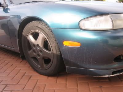

these are my stock wheels i had laying around i took of the messed up wheels, but yea if u look carefully u see the wheel has an odd angle and when u turn the steering wheel it spins like 1.5 turns and then slows but does the right turn super quick. weird feeling.

those pics dont tell anything, when ppl say post up pics they mean of the damaged suspensions links, not your stock wheels and exterior, post them up so we can help out

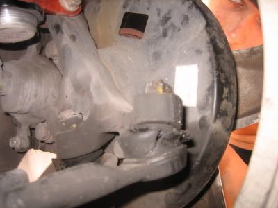

does this look like a bent tie rod end to anyone

wow.
replace it already.
damn.

wow! That's a broken/bent tie rod bolt! Never thought I'd see that.
As already mentioned, if you're gonna upgrade get SPL rods and ends. Much beefier than Tein.
BTW do you have a vlsd in that thing? I used to skid a lot in the rain with my first 240 without one.
I was going to add a 'why did the angrychicken crossed the road..?' joke here but I think you've been through enough already.
Good luck.

You know, lets hope there isnt any structural damage. We have had cars come in from the same exact thing you did, and the insurance company salvaged it because of frame damage. Once you figure what the problem is, I suggest you stop drifting on the streets. Its not cool...in fact its idiotic. I dont mind noobs asking technical questions but seriously, when I read a post like this... I think, you got what you deserved. I am just happy that no one was walking on the sidewalk that you hit.
Eloy
Race Precision Inc.
