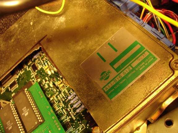

SR WTF is #11 ECU from? (See pic) Not 62, E5, etc
I bought my car with a S13 Blacktop SR20DET in it but blew it up and I replaced it with a S13 Redtop. I Swapped over all the manifolds and sensors and its runs just fine but I never noticed until today I have a #11 ecu?! WTF is that from so I know what to set the output on my SAFC to?
I thought these were the only SR20DET ecus:

To answer my own question, stock SOHC KA24E ecu? Wow I guess they swapped the guts into that case or something? It is tuned for Z32 maf and 550s and runs great but I cant figure out what to set my SAFC setting at. 2in 5 out runs best I think. 2in 6out runs like total ass. Any insight anyone?

j/w do u have a picture of the old engine... im not doubting you, but are u sure the original engine wasnt a ka24e-t?

lol no I assure you it was an SR. The car is a 90 so it was a SOHC at one time obviously but seriously how do you explain that?

was just wondering, thats kinda weird that they'd swap the ecu internals, its actually kinda strange if you ask me, but then again its a tuned ecu so it doesnt really matter
