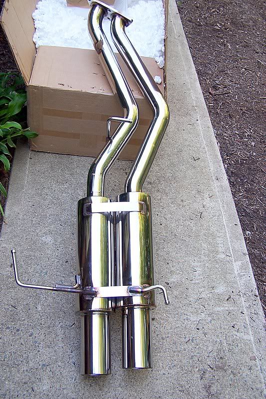

here are the pics:
the "package"
The packing:
The unwrap:
Rear section:
XS POWER TAG:
TIG Welds:
More pics tomorrow. Install took place at night. 5 minutes to remove old exhaust. 20 min to install new. I am anal with the Ultra Black on the gaskets and Anti Seize on the bolts.....Fits good. One hanger was not welded properly(the one with the 12mm bolt near axle)

You got a pic of the mid section? I want to see what kind of design they used to bolt up to that weird dual flange.

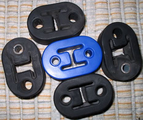

I did not have to modify anything. Only bad thing so far was the chassis mounted hanger was not used. (placed incorrectly on exhaust...still)
I guess they made a run of 1 million or something, they never fixed the bad hangar after a year of selling these.

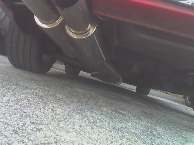

After installing my X02 T25 manifold/SR T25/ and an aftermarket 3 inch SR downpipe on my KA-T, It pulled my Name brand Apexi N1 duals up into my driveshaft. It's nice it pulls it off the ground a bit, but the angle of the downpipe did this to mine. Also, my chassis hanger isnt used on my Apexi either
SSAC doesnt look like a bad deal, hopefully the welds are better than Apexi's; as well as the whole unit not weighing a metric ass load, like mine. Broke welds in 2 places (on the hanger between the resonator and mufflers), and into the cansiter.
I have no complaints on the N1 dual system, it looks great, sounds AWESOME, and I get alot of compliments on the style.

Originally Posted by S14DB
New bushings FTW!
where do you get those from? nismo?
slideways2004 is offline   Reply With Quote
Old 08-23-2006, 08:47 PM   #28
S14DB
AFC #1
S14DB's Avatar
Join Date: Oct 2003
Location: 昨晩あなたのお母さんの家
Posts: 20,181
Ebay, delubozparts. Polyurethane Exhaust Hangers. $26 for 4. Just stuck them in the microwave for a minute and swapped them while they were hot. Sucked the exhaust into the body cleanly. Never fit better. No more rattles against the body. They will never come off unless I cut them off they are so stiff.
