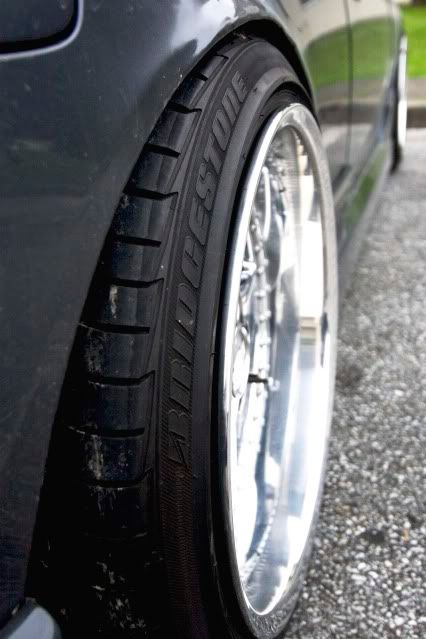

For my daily, im running 265/35 18s in the rear with 235/40s in the front. Fronts are a bit taller, figured ill shred the 265s and run 275s to make up for it.
Fronts, 235/40 18 Dunlop Star Specs and 265/35 18 Bridgestone B5000
PS: Dont mind the stretch...Im running staggered 18x10 +18 and 18x11 +19
