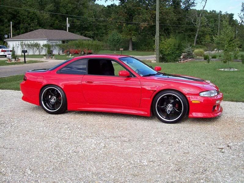

Originally Posted by BlackS14
Thanks a million guys...here's my next question.....can anyone forsee problems with using the CS fenders with say like a full kit from Origin or Vertex??
-Bill
You shouldn't have any problems. I have a Version Select body kit on my car w/ Origin Lab fenders (practically same stuff as CS) & they fit great together. I have it sitting on some 9" wide wheels up front (no rubbing issues at all) & 10.5" in the rear.
OMG......Cisco you're car is gorgeous.....quite a bit what I want mine to look like...only black in color....Jesus. Two questions....are you running stock rear fenders (looks like you are)? And do you have some different pics from different angles....rear, side, front...post em away...please...
EDIT...oops..three questions. What brand and offset are those wheels?
-Bill
Thanks, I was acutally thinking of black before I decided on the red.
1. No, I am not running stock fenders. I have 50mm overfenders molded in & had the gas cap/cover/lid made to sit flush w/ the fenders so that is looks almost stock (I didn't want it to be real obvious).
2. I do have some more pics. I can post some up later, but for now I'll just post my cardomain link: http://www.cardomain.com/ride/2064334
3. The wheels are Racing Hart R5 Pro in 19X9 & 19X10.5, I can't remember the offset though.
Here's a pic:
what offset are the wheels? BTW your car is probably my favorite 240
