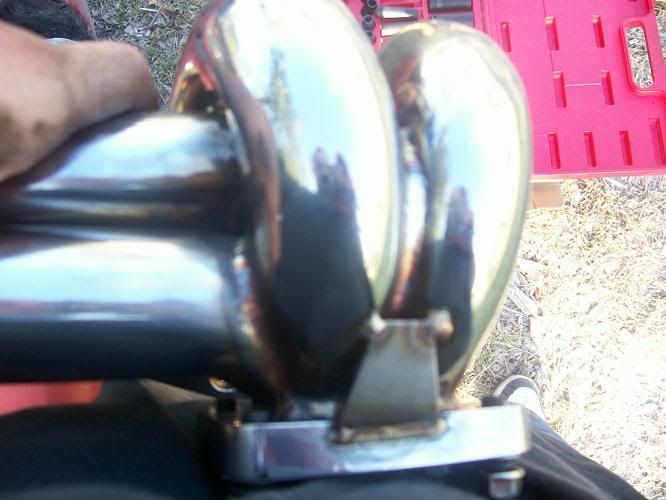

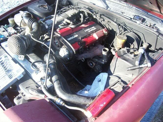

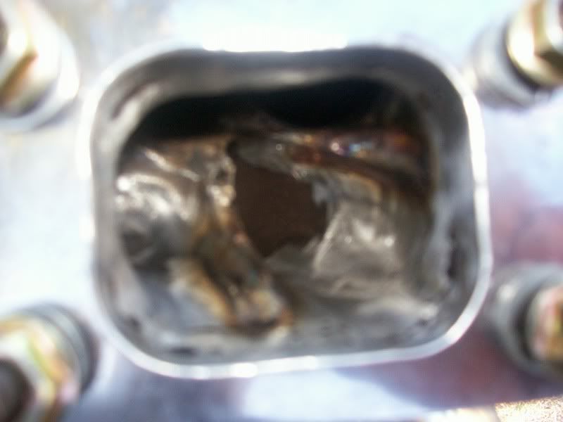

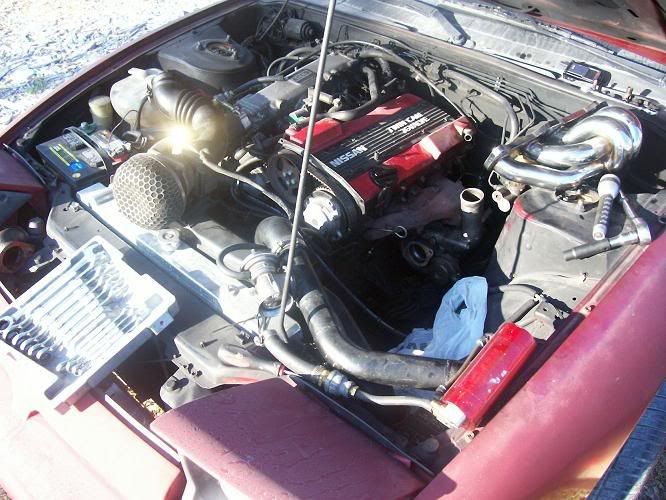

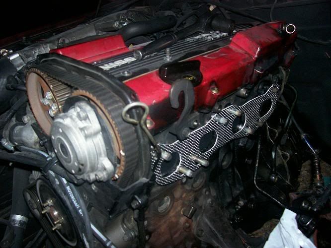

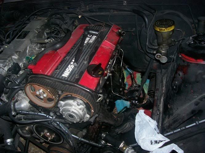

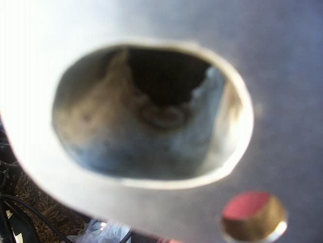

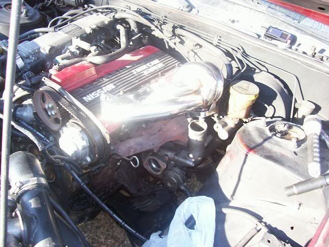

well i orderd one about a week ago and here it is, the quality looks excellent and the welds even better, it is fully ported i have some pics of install will be done tommorow, i just made this for those who are skeptic about getting these

It might be ideal to wait until you put some miles on it before you make a decision either way.

the welds are fairly decent and i can't wait to put them on my car. the price are also reasonable too. reason why welds either cracks is because of heat expansion and temperature changes. a friend and i talked to mack at mckinney. they used the megan manifold on their own cars. always expect the unexpected. any manifold will prone to cracking except stock cast.

put some miles on it before you assume how good it is. also, i suggest better gaskets. especially for the turbo one. not sure where to get them for that motor. maybe teh same as sr

please please please PLEASE get rid of that gasket. They are garbage.

The man speaks the truth.
That gasket is going to be gone in less than a month.

from what ive been hearing, this manifold is only as good as the engine mounts. As long as the engine doesnt flop everywhere it shouldnt be at risk of cracking the welds. If you are that worried about it cracking, find someone to brace the manifold.

woah hahaha havent seen a CA18 in a while.. i forgot about those motors..
I didnt know meagan made a ca18 manifold. You should look into cutting down engine vibrations with a engine brace or motor mount, they really help the lifespan of your manifold.

Not only is quality motor mounts needed, but so is a flexpipe. That makes a great deal of difference also.

that manifold looks like ass

thats not a megan manifold.

hey philly, do you have a problem with the 3rd upper stud from the front of the engine hitting the header? I have the problem and i am wondering if its with other manifolds also.

Don't use the shit gaskets they give you...get OEM replacement stuff
