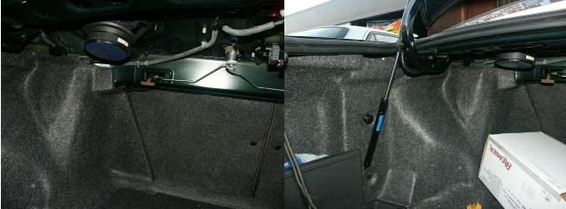

First remove tension springs.. ::::caution:::: can be dangerous, make sure you have someone hold the trunk while you remove the springs, cause the trunk is heavier than you think it is.
I did that on my accord so the mounting places can be different. But there was a pre-drilled hole in the trunk hinge, so I drilled it out bigger to fit in a bolt and nut. Next find a place to mount the shock, and from there it's pretty much trial and error. The shock is VERY STRONG so don't expect it to be easily compressed. Just make sure you purchase the shortest shock you can find, there were shorter ones but there were sold out. They go for about $20 each.
It took about two hours, looks easy, but it's not. If you do it faster..then more power to you.

anyone know how to install those bars im having a hard time. 95 240sx

Take a closer look at when this thread was started. The only new question here is how to reinstall the spring bars. Everything else was figured out 2 YEARS AGO.
