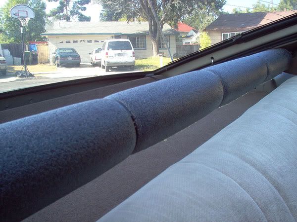

just buy a 4' section of piping from home depot, cut it to size, hammer the ends flat and drill 2 holes. Best c pillar bar imo, no adjustable brackets no weak points, just fucking beefy. Trust me i came up with this idea long time ago, and lots of ppl use it nowadays. Wether it be dohc or sohc dosent matter and you can still use stock seatbelts. did for 2 years with no problems. and what cost like 5 bucks? if that, and u can polish it super easy or paint it. 6 bucks will get you the best cpillar bar $ can buy

sheesh i thought everyone in the bay has seen my car. umm man those pics are 2 years old imma have to find out which hard drive its on ( have like 5 hard drives) haha if i can find em ill post em. var did his on pinky (sohc) and got it the first time

any pics of yr c pillar bar? i wanna see how it looks like

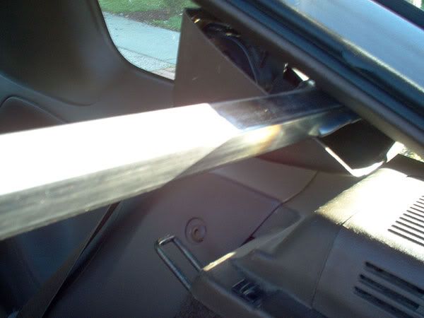

i 8 did exactly what I would have done if I had a dual... square aluminum extrusion

Just heat up the edges and pound it flat.. then measure where to drill holes.. then drill holes.. then bolt up
How different are the SOHC points? I never really took a close look at them.

so are you using the mounting brackets from the rsx bar or 240sx bar or are they the same?

Only downside to Home Depot piping is that it's heavy. Probably about 3 times heavier than a billet pillar bar. But besides that it's great because it's so cheap.

Yes it is using the brackets and bar from an rsx. The brackets are fairly universal and it fits like a glove.
nrg: you would be surprised with how much the rest of the car flexes. If this wasnt true then why would adding a sunroof or driving a convertible cause the chassis to lose stiffness?
Wanna find out how much the car flexes? take a piece of string and tie it tight from one seatbelt bolt to the other. have someone whip your car around taking hard turns and beating it up, you should actually be able to see the string go limp/taut. This is a great way to establish points of weakness in any chassis, not just the C pillar.

CLEAN INSTALL yet sacrifice rear seat belts
