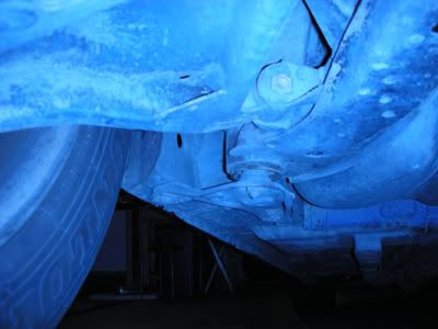

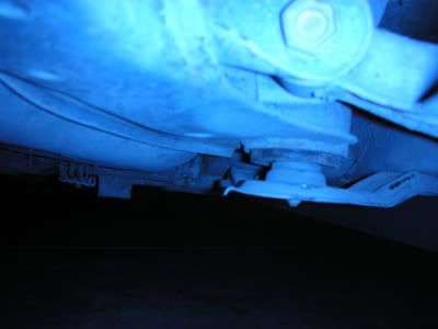

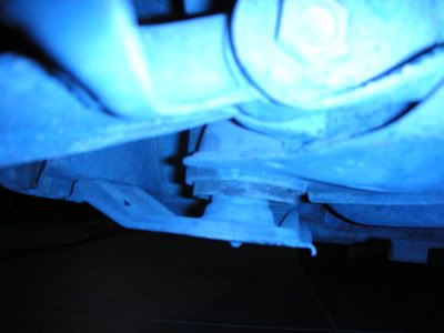

when i jerk my tranny around
i can hear a popping sound in the back of my car
i knew my tranny mount was bad
so i changed that today
nismo mounts
but it still did the same thing
and so i jacked up the rear end by jacking up the diff.
and i saw the whole back end suspension shift
it looked like they werent supporting the rear (whatever you call it, suspension)
http://img.photobucket.com/albums/v4...gerside_02.jpg
http://img.photobucket.com/albums/v4...gerside_01.jpg
http://img.photobucket.com/albums/v4...verside_02.jpg
http://img.photobucket.com/albums/v4...verside_01.jpg
it looks like theres too much spacing. i have no idea what the parts are called or whatever.
i need help. its pissing me off badly. please help with anything.
**UPDATE**
i figured it was my subframe bushings.. thanks for the link!
alright. for the vibration. here's the story. i never really had this problem before. i lowered my car with some tein lowering springs my friend gave me for the time being. thats when i noticed a lil vibration. i checked under the car and i saw that my stock tension rod bushings were broken so i changed those. i bought kazama tension rods and installed them. but that only made my vibrations worse. i have gotten my tires balanced and it didnt work. do you really think i just need an alignment?

It's called Subframe bushings.

lol thanks. do you think that space right there is normal?
the whole rear end drops maybe like an inch when lifting it by the diff.
the other thing is, would this make my car shake when reaching speeds of like 70-80 mph? i feel the vibrations from the front.

And if the subframe itself dropps an inch when you lift it up that is not normal and your subframe bushings are worn out.

You should get subframe collars. Bushings are a pain to install.
That will fix the rear end problem.
You should get your tires balanced. Vibration comes from your wheels needing to be balanced. But get an alignment also just because chances are you are long over due. And you have a slight drop.
