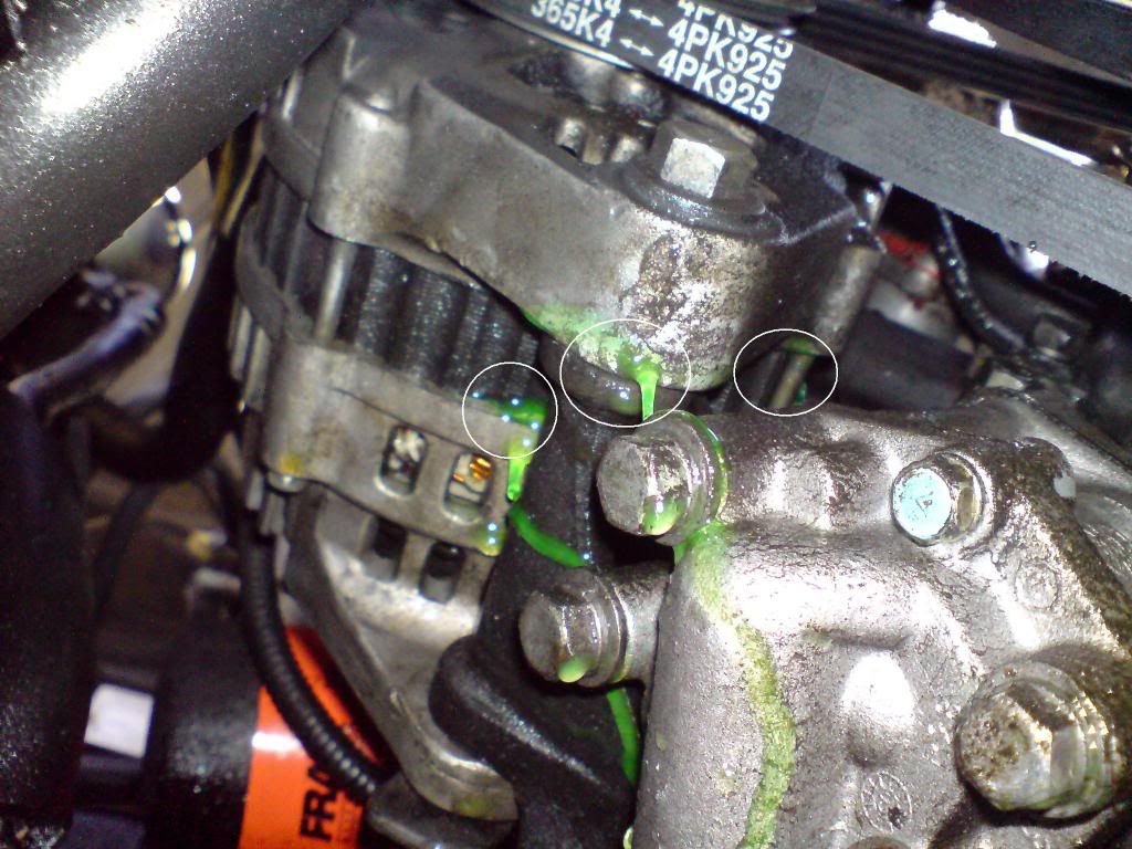

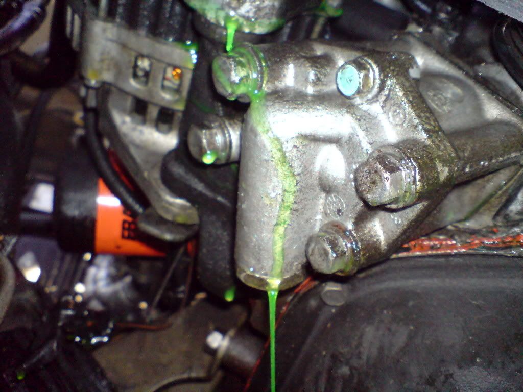

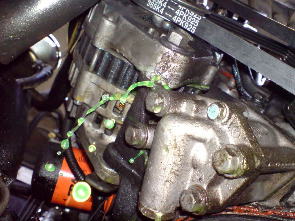

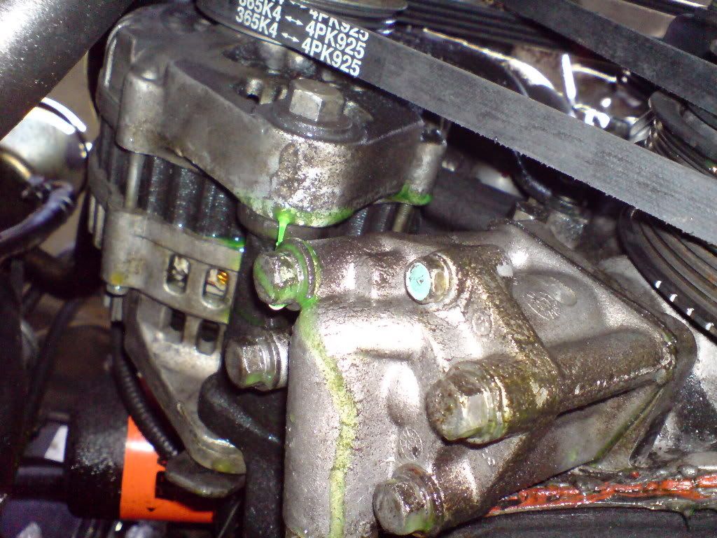

Back! Alright, so this is what I did today:
I jacked up the car, opened hood, added extra water coolant into radiator, waited for a few minutes and then....there was some noise under the car that goes...drip..drip.drip..drip...so i looked under the car and the coolant is spilling out like it's having an orgasm!.... Okay I looked under the engine and took some quick pictures.
The picture that has the circles might be the place where it's leaking from but dunno what is. I think it could be the radiator hose that's connected to the engine?
Any of you know exactly what the problem is? I really want to find out where this crap is coming from. Thanks.

Hey, Yeah its the bottom radiator hose. That thing was unpluged from the engine. Do you know how i can get into that hose and re-clamp it or replace it? My guess is to remove the intake...dunno though

Also, looks like it's coming from the upper hose or intake mani coolant hard lines. I had a problem once with my S14 where the small metal tube coming off the upper hose mounting point to the manifold broke clean off!! It was just old and corroded clean out. Leaked just like that. I hade to replace the entire upper intake manifold!!! That little part can't be replaced. You could probably get a shop to weld it back on but no guarantees it'll work right...

It's coming from the engine side I assume. Replace the thermostat and pull the hose completely out to check for cracks, also replace the gasket to the thermo housing.
Sorry I posted before I read your last post.
Yeah pull the intake piping out, it's easy from there.

Ok!@! wow, looks like it's coming from the top of the alternator, so check the water pump, throttle body, and IACV coolant lines.
Any coolant on the belts? What about tucking in paper towels at various points of leakage! Worst case block cracked...

Back again. Hey thanks for the posts. I figured out the problem. The bottom radiator hose was unplugged so i plugged it back in. ^_^ I was happy that my car seems to be ok. BUT, after clipping it back on, adding water coolant, I started the engine to see if there are any leaks coming out again...none. Now the only thing that is pissing me off is when i start the car, i hear a knocking noise in the engine.I wondered if I just leave the car on for a few minutes it will go away, but sadly it didn't. Any ideas to where in the engine it's coming from?
