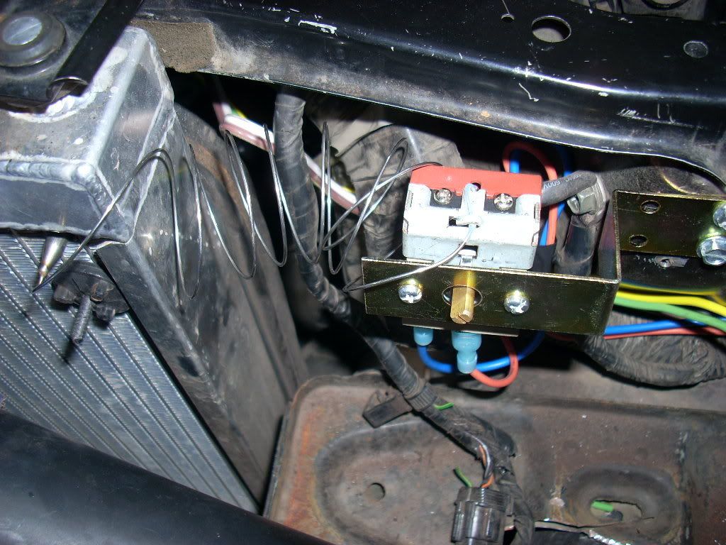

so i went to the local parts house and found a shitty hayden temp sensor as shown:

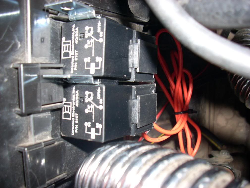

after hooking it all up i run the output signal into two relays:
note 30/40A relays

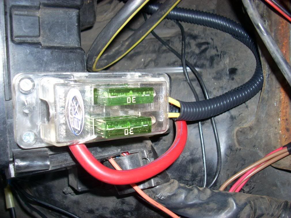

and then i hook up a maxi fuse block (small fuses blocks were melting in 1/2 due to massive heat, i went through about 5 of those things since last fall too):
so basically i am just using the thermostat as an "on" signal for the relays that then pipe the power through 14 gauge wire to the fans and back out to the ground near the fuse box under the hood. i will let you guys know how it holds up, but i figure at worst i will end up replacing relays now instead of e-fan controllers.
