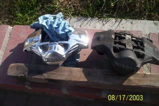

well i finally got a day off and was bored so i thought id try a new project on polishing my z brakes. Seeing as how i have polished many things b4 i thought this might be somthing kinda cool. i havent really seen any pics of the polished z brakes but im sure there is but well here are mine still in progress and few of my other projects that ive done.
p.s maybe for sale here in socal soon ![]() ![]() some hayashi wheels ![]() ![]() valvecover, sold here on zilvia ![]() ![]() |

well first i did some heavy grit sanding to try and smooth all the casting marks off then used brass wire wheel to get some of the oil and other stuff off in hard to reach areas now i am using 220 grit sanding to smooth stuff and will just work using finer and finer grit till its really smooth and polish it all with some compound.

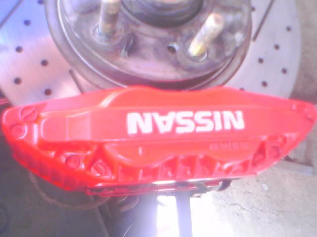

I was gona do the same thing but decided it is too much work.. so I just painted em red.
they wont look like that for long unless you keep cleaning them^^ I guess thats expected from any brake finish though |
