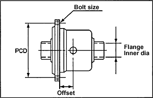

Tomei uses the Type A, AX, C, & CX on the S-Chassis.
The only difference in the A & C is Ring Gear Bolt Size is M13(10) on the C-model. X is the designation for using the stock side flanges.
Type - A
PCD - 150
Offset - 33.1
Disk diam - 105
Disk - (in) 4/ (out) 4
Disk thickness - 1.7
Spring pitch - 4
Ring gear bolt size (number) - M12(10)
serration tooth - 29T
Flange Inner dia - 32.0
Default Initial torque (kg.m) - 12.5 - 15.5
Pressure ring Cam angle - 60×60/60×40
Originally Posted by Tomei's Website
Large size clutch is required for the LSD that is corresponding to the tuning engine, for efficient transmission of the huge torque. For the example of Nissan, capacity of the clutch is secured 127cm2 per one disk, which means total effective friction area will be 764cm2 (63.7x2 sides x6 disks). It is the largest friction area among the others.
I'll try to get info on the Cusco RS LSD... not mush listed from what I can see.
