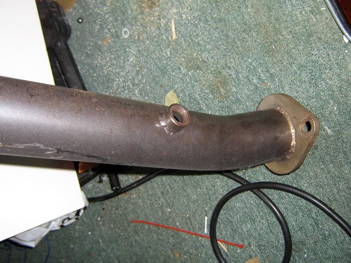

You see that there little hole on the downpipe ^^^ with the threads? That's a bung.
