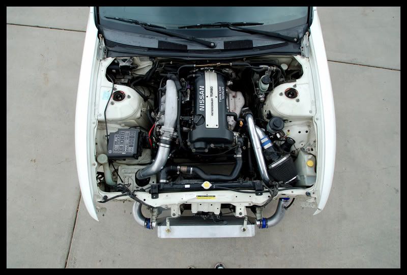

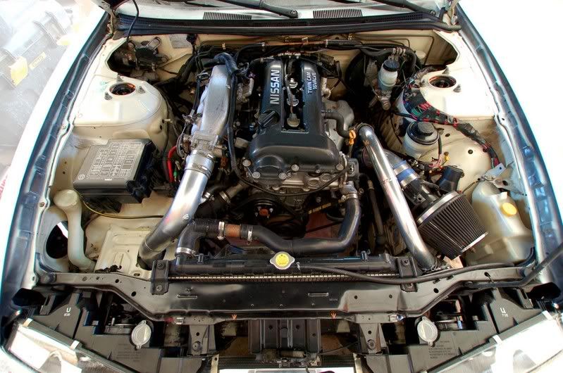

my car before i got a new radiator:
i know its not clean. but hopefully these pics help with what your talkin about
it uses the stock KA bottom hose
