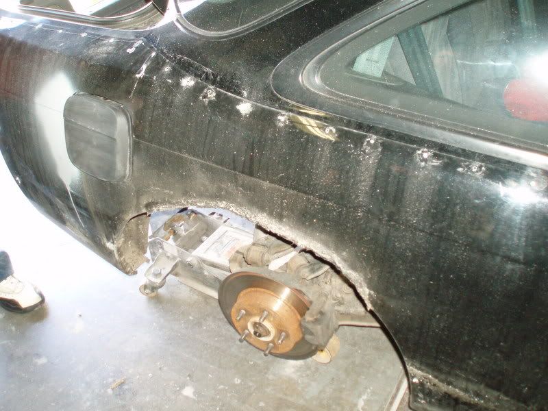

okay so did you take out the rivets holding the overfender on when you did the molding?

mold is going to crack. show cars for the win. rivets are where its at
but looks nice though... just dont drift

so why didnt you just leave the rivets and bondo over them? that would have made it stronger, which is always better, and made it a hell of a lot easier. but nice write up none the less

I did not use rivets because it was a smoother transition.
Fiberglass and panel bonding glue are very strong probably as good as rivets

Two part epoxy is stronger than rivits... WAY MORE CONTACT.

everyone who has widebody fenders, make sure to not do anything in this writeup, its retarded
are you fucking serious about that? is that fender done???
everyone who is doing widebody
make sure to cut at LEAST 1 inch above the body crease
the way that fender is cut, the shit will cut your tire in half if you tuck like .02 inches of tire.
in case u didnt read above that is what the dumbass that owned the car before me did. I said dont do it this way.

^Then maybe in your "DIY" you should have shown the correct way to do it..Because as it sits your looking like the dumbass.
