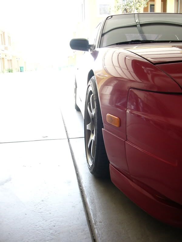

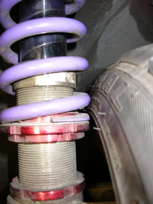

sup everyone, wanted to get some opinions of my fitment and what i encountered.
s13 fastback (stock fenders)
17x9+20 + 235/40/17 Federals (all around)
Tein HE's
Front - Ichiba hubs
Rear - S14 SE hubs
The wheel originally mounted barely without a spacer when it had no tire, after mounting the tire i had to use a 5mm spacer (see clearance bellow). It doesnt rub but it looks rather close. I also did a 5mm spacer in the rear.
Rolled front and rear fenders, relocated the harness, banged inside of the fender well, no rubbing.. concerened about possible future rubbing issues when the tire starts to flex at higher speeds. Car needs an alignment, since after the ES master bushing kit install everything was thrown off.. front camber is all the way negative right now.. hopefully with proper alignment i can pull back on camber a bit and still clear the fenders.. No outside pics yet as i'm still trying to decide if to raise the rear or drop the front some more? I wouldnt mind going lower but circuit sport midpipe is hanging pretty damn close to the floor.
From what i've researched many got away without spacers on HE's, for me it didnt work, yet other say that its almost a must.. not sure if it matters due to tire brand but in my case for sure it will not clear without a spacer. Any advice is greatly appreciated. Many tks in advance!

trust me when i say that'll fuck up your coils, it'll rub and rub bad, the tires will rub the coils and it'll spin and it'll rub, rub, rub
get some spacers, i'd post up pics of my 17X9 +27, 235/40/17, but i'm too lazy, it's on the Group Buy:MB motoring wheel section... i need at least 5mm on my jics to clear without worries, but i used 10mm... rears are not a problem of course

im at 17x9+15 now with that 5 mm spacer.. like i mentioned i dont see anything rubbing, there is little space left but not much, my only concern is for hard cornerning as the tire is bound to flex a little.. that little can hit that coil.. a quick fix would be wider fenders that i just dont dig, i know it will solve the prob right away. Perhaps try a different brand tire later?
I'll get some pics up tomorrow of outside hopefully maybe drop the front some rear and see where it will start to hit the fender and check exhaust clearance as well..

just by looking at your pics above, it really seems like the tire will rub on the coil, the rims won't ever touch, but the tires look like it positively would... after a while, if you notice rub marks on your springs, you'll know that you need couple more mm in spacers or run thinner tires
rears are not a problem with that size, no spacers needed

this rubs
and that's 17X9 +27 from the outside
+17 (fronts) from the outside

many tks for advice, i will most definitely keep an eye on the coils and see what happens. As for rear only reason why i went with a spacer is to match the front and keep the track width the same as stock of course with bigger wheel/tire combination. Back is no probs at all.. plus i like the rear ride height.. :-) need oem sideskirts badly now.. :-)

Originally Posted by Ca_laurier View Post
true, on s13's you can run 17x10 with a +35 offset in the rear
i have just never seen a +20 offset have inner clearance problems like this
I run 17x9 +15 in front, and if I don't use my spacer, I have like 3mm of spring clearance.

to those that are running similar size offsets like me what coilovers are you running? i knew HE's wouldnt have a good clearance period, but what other models would have say optimal wheel to coilover clearance?
tonight i will adjust the knuckle and see how far this gets me, and if that doesnt help i'll try 8mm first then like aaron said 10mm up front will clear like there is no tomorrow :-)
no what i was getting at was a higher offset on a 17x9. almost looks like its close to +30
