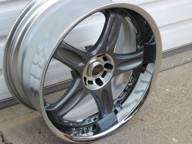

POLISH???!
Get some "Mothers Metal/Aluminum Polish" in the JAR. And Polish it.

damn that is super sexy... i like them.. how long does it usually take you to polish all of that. ill tyr to get some pictures of my rims up tomorrow cause right now its 11 PM rite now. Damn those are sexy.

Damn johngriff. You got that done at a shop right? That is so clean. How much did it cost you to get it done?

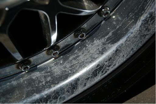

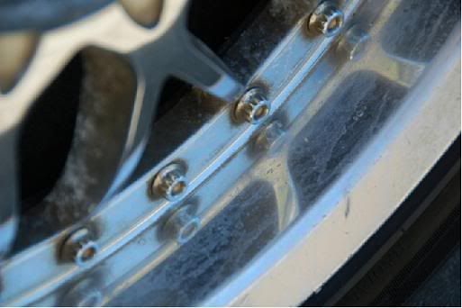

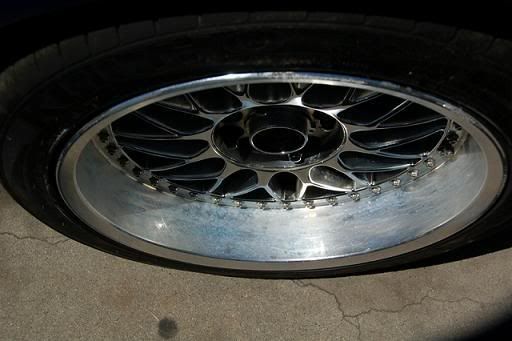

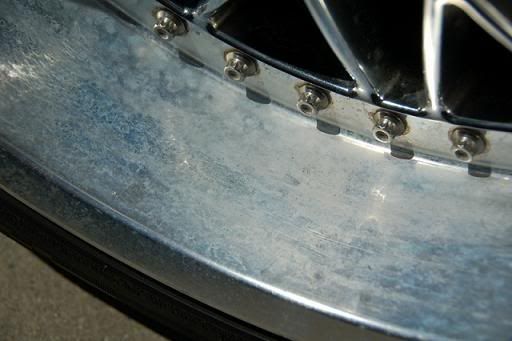

here are the pictures:
VOLKS:
STICHS:
thanks for helping me out -kouvang

It looks like your wheels may have/had some clearcoat on the lips. Using a metal polish will not bring the shine back. If the clearcoat is still intact and not chipping, a cleaner wax may work to bring back some shine. If the clear is already gone or chipping than you may have to remove all of the clear and use a metal polish!
+1 for Mother's for metal polish. Its good stuff. Ive heard if you use the billet aluminum polish on bare metal, it works alot faster. GL

Yeah, you will need a machine polish, like the wheels i posted above. If you were local, I would hook you up, unless you want to ship.
