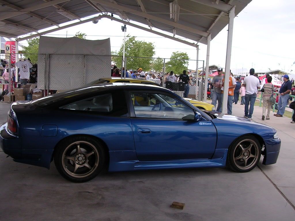

U dont need core suport u only need fenders hood bmper and lights, be a little creative and will fit easy

yea you just need the fenders, hood, bumper, and lights from my research. I'm in the process of doing that now. Already have everything except for the fenders. My question is does anyone know anyone IN THE USA that sells conversion fenders besides raceonusa? I dont want some crap that doest fit. Bik would know what hes talking about. I think hes got the S13.4 zenki. I'll have mine done within a few weeks and I'll post up pics.

my friend just recently did it with his zenki s14 front end pieces on his new s13 hatch.
he used the stock (s13) core support and used the headlight brackets from the s14. I'm not too sure about the bumper tho (not the bumper cover, the actual bumper)
honestly, it looks a little funny to me, as the s14 is a little wider, it looks like it has oversized fenders on the front.
I'll try and get some pictures of it up soon.

yeah the s14 is like 3/4 or 1 inch wider, nothing then a little pull on the back cant fix, i wide it a little on the back
to put the ligths is easy, the outside bolts on the fender, the inner side will "bolt" in the core suport if u reverse it
y have to make a hole on it so u can bolt the head ligth, the interior of the bumper have to be cut too to fit "your car will be ligther" hehe
check out how the back is wider, now i need some spacers for the wheels Y_Y
yeah my interiors was brown "shit", i paint them grey, call me ricer!!! please do it!!! O_O

damn bik, your cars a inspiration. I've been searching arround for about a month on this conversion and your cars everywhere, all the forums and everything.
You have kouki corners and zenki headlights correct?
Did you cut and weld your fenders, or did you buy some conversion ones? What headlight brackets did you use, silvia or 180sx? Looks like it just bolted straight up.
Did you have to cut a hole in the radiator support to have rear clearence for the headlights?
You said that you didnt use a bumper support at all, so where is the bumper bolted to, just the fenders, or somewhere in the middle, and if so where?
For the hood, did you just modify the stock hinges, or did you buy the S15 ones?
Sorry for all the questions, but like I said, you the only one I know of thats succesfully done it, and I just dont like running in a forest blind folded with kinves straped to my hands. Thanks
