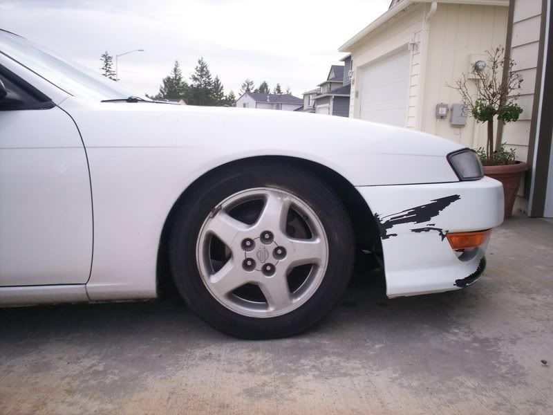

so basically i understeered into a curb last night in my s14 and afterwhich the wheel is not centered, it is now closer to the back of the wheel well. i took the wheel off to see what was bent or broken but i cant obviously see anything. please help.
[IMG][/IMG]
so i finally took some pics of the damage...i believe its my lca correct? where can i get a replacement?

so your saying you now have negative caster on only 1 wheel?

yea thats exactly what im saying, ill jack up the car tomorow and take pictures of everything.

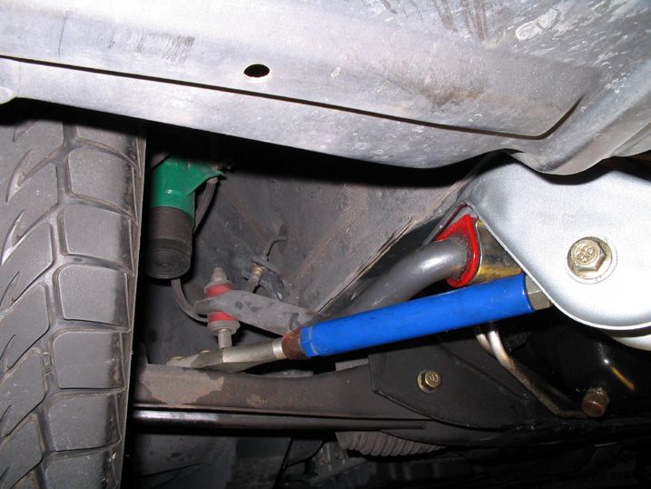

s14
bump. now with more pictures. where can i get a cheap lca?

caster wont uncenter your wheel in your wheel well, its clearly shown in that picture. even if your caster is changed your wheel doesnt move.
WRONG, well sort of.
Caster gets thrown out of whack when the front suspension/steering components get bent thus throwing the wheel back into the wheel well.
Simply put this causes the wheel to be positioned BEHIND the strut due to the bent parts, thus causing one wheel to be "behind" the other and leading to a caster/pull problem.
I guarantee you your caster is at about -5 to -7 on the right wheel. Most passenger cars are designed to have about 1-2 degrees higher positive caster on the right so as to offset "road crown".
I'm sure he has a horrible pull to the right.

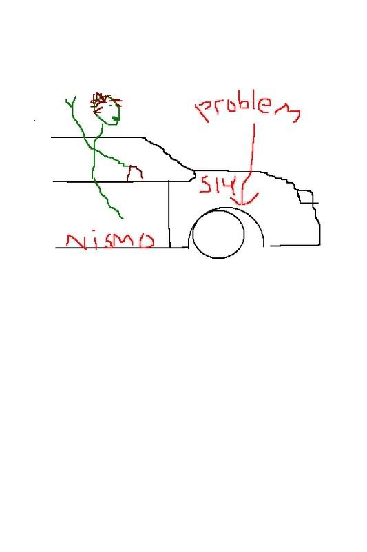

check your front tention rod, i bet its broken... also take a pic of the front sub frame where it connects to the LCA
LOVin the illustration!!! lol
It's actually pretty hard to break them. You will snap the LCA before the Tension rod.

is its supposed to be bent like this?

no .

well its not supposed to look like that but I dont know if that picture was taken before or after you replaced the damaged components. The tie rod looks crooked because your castor is off. It doesnt look bent though. So after you replace the other damaged parts see if the tie rod still sits like that. One option is to get an adjustable tension rod to get your castor back in spec. But you may end up having to replace the rack.

If something else like your lca is bent then it will cause the spindle to sit differently and that will cause the rack to sit in a different postion. So check everything else before you spend money on a new rack. Your lca is probably bent maybe tension rod. Ive hit alot of curbs and bent the lca almost everytime.

I just noticed that you added pics at a later time. The LCA is gone and prolly the TC rod too. Take pics of the TC rod and the TC rod bracket.
Get a shot like this please:
