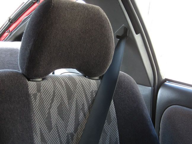

I used a Z32 upper mounting bolt and added two washers equaling about 1/4in.
I made a 3/4in hole under the middle mounting tab on the back of b pillar plastic then shaved off the mounting tab.
Total cost: $0

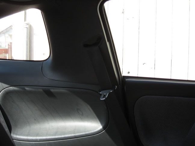

i did this on my car.
i love to make it clean..
IRRegular Kids!!!!
vespaman is offline   Reply With Quote
then you should get some door welt and cut it down to go around the edges of the hole area then it would look very close to original JDM

That's SORT of like how mine is...
http://bhworld.wordpress.com/

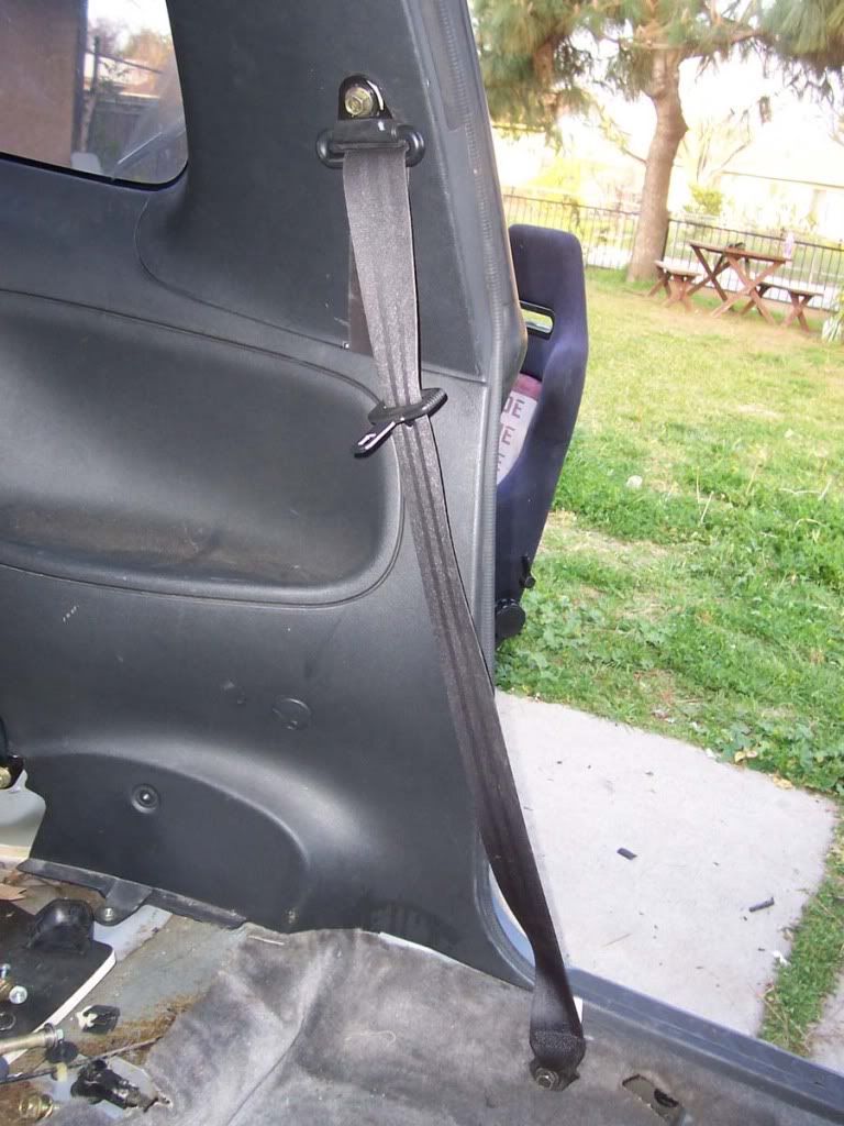

Never understood the automatic seat belts..
Took my sweet ass time to cut these holes!
180sx seat belts
