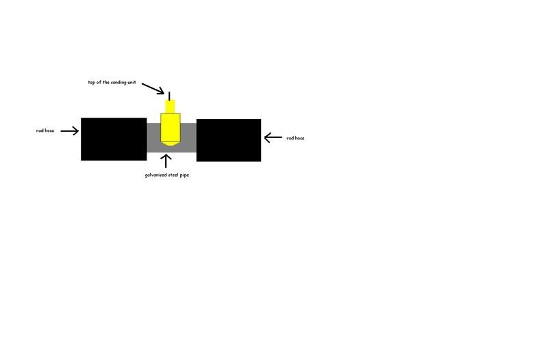

i searched through 12 pages and none of the posts answered my question.
i have the sender unit threaded in a peice of 1 1/4 pipe in my rad hose
sorry if the writing is too small
but my question is what do i use from the sending unit to the guage? do i use 18 guage wire or something else?

Yep, I ran a small wire from my sender to my guage. I don't remember what gauge but 18 should be fine.

Do you put it on the top or bottom hose??
top hose for sure.

ya its the top hose, and i'll try a wire then, thanks

18 is adequate for that sensor.

you also need to run a ground from the ADAPTER... so put a wire on the adapter.. and ground it out
i had to do this with mine for some odd reason.. not sure if yours will be the same.
I think this is necessary if you don't mount the sensor on the block.

yea i saw he was doing his on the top rad hose.
