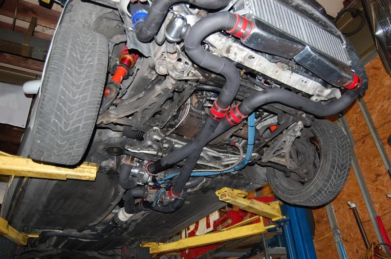

Rear mounted turbo?
Anyone ever try a rear mounted turbo?
I know domestic v8 guys do it.
I would imagine more lag for our cars
...but does anyone have any info on it?

I would imagine the only benefit is keeping the engine bay looking stock.
that and maybe the fact that sometimes you dont even need an intercooler.
but its flaws probably would be trying to put together the piping and a slammed s-chassis.
or trying to locate a boost leak.
plus more pipes to fill = more lag.

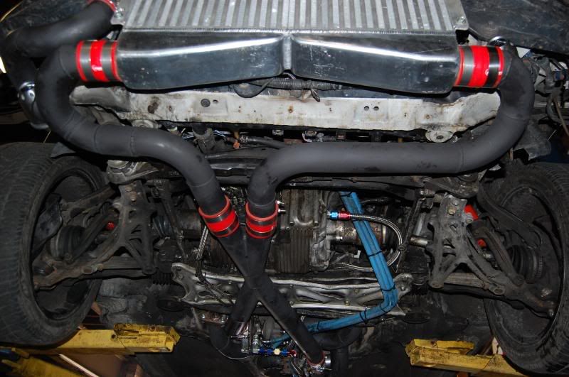

i believe since american cars have bigger motors, there is less room under the hood, and that is why they resort to the rear mount turbo.
would be stupid pointless for an s-chassis though. more lag and if you hit a puddle you're fucked.

Theres supposedly no noticeable turbo lag from that set up even though theres a ton of piping. It wasn't some hack job.
Benefits would probably be, lower temp at the hood.. passing visual inspection...
Cons would be.. tons of additional piping/weight which can be countered by more power
actually since most of the piping is in the length of the car and not in the front, it wont be worse than an fmic

It wouldn't be worth the effort on a 4 cylinder powered S chassis car. It's possible on V8's considering the exhaust flow of such engines. Your 1998cc motor isn't going to produce enough exhaust flow to spool that thing at a decent RPM..
Other than being cool there's really no reason to do it. Can you imagine trying to run 90mm intake piping through an S chasis?
Actually looking at that setup it seems like a cheap way for V8 guys to run a single turbo...

Guys, this is STS Turbo territory: http://www.ststurbo.com/
They've invested a lot of money in this technology and hold several patents on it: http://www.ststurbo.com/patent
Patents are here if you're interested:
http://www.google.com/patents?id=bWU...J&dq=6,745,568
http://www.google.com/patents?id=bW5...J&dq=7,134,282
It's a good way to keep the engine bay clean. That's their whole rationale for designing this system.
If you're going to design your own system make sure you understand the extent of their patent coverage and don't infringe. STS is very aggressive with their patent enforcement.

I'd be worried about something in the road hitting the turbo and the oil return since the turbo is only a gravity drain more less.

Check out this guy's Q45
http://forums.nicoclub.com/zerothread?id=219609&page=2
Scroll down to a post by qsiguy.
i like! very very nice set up!

damn thats a wild setup, what kinda car? 240?
