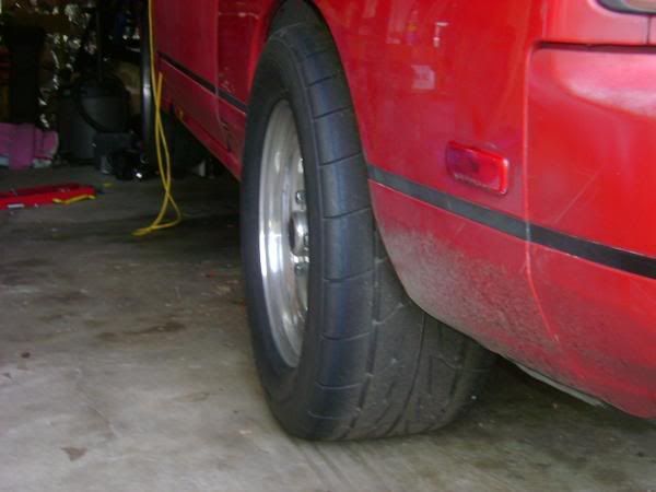

Those are my slicks Next to 255/40/15. With 265whp a 8 inch slick will do just fine for you. Putting the stockers back on the front will help, less rotational mass that the car has to push.
