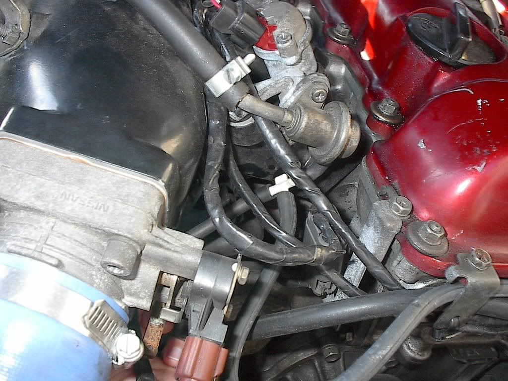

Send a message via AIM to Steeles Send a message via Yahoo to Steeles
do me a favor. go take a picture of our vacuum setup near your FPR...

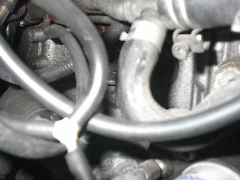

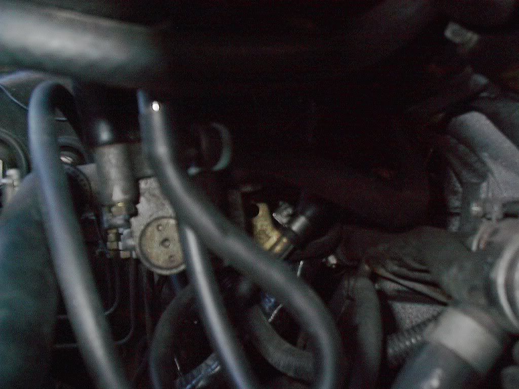

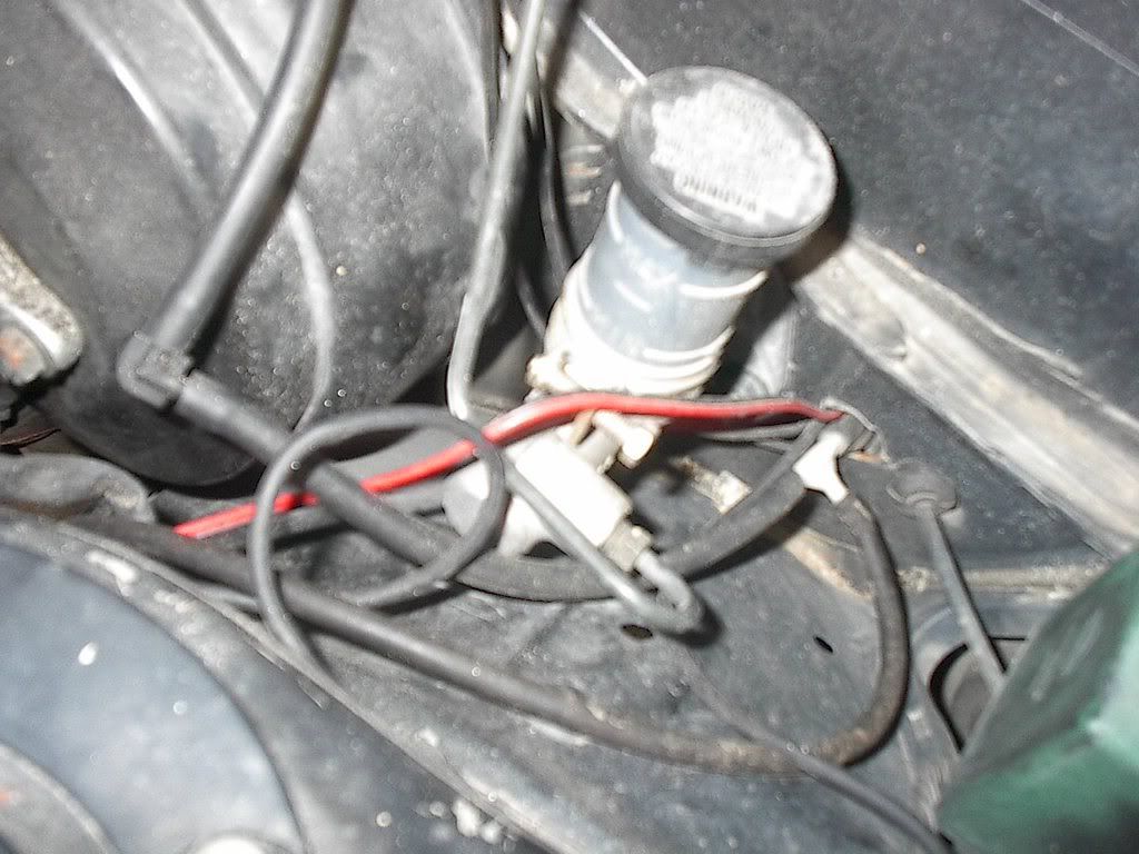

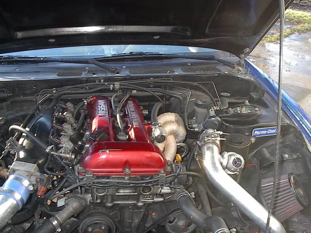

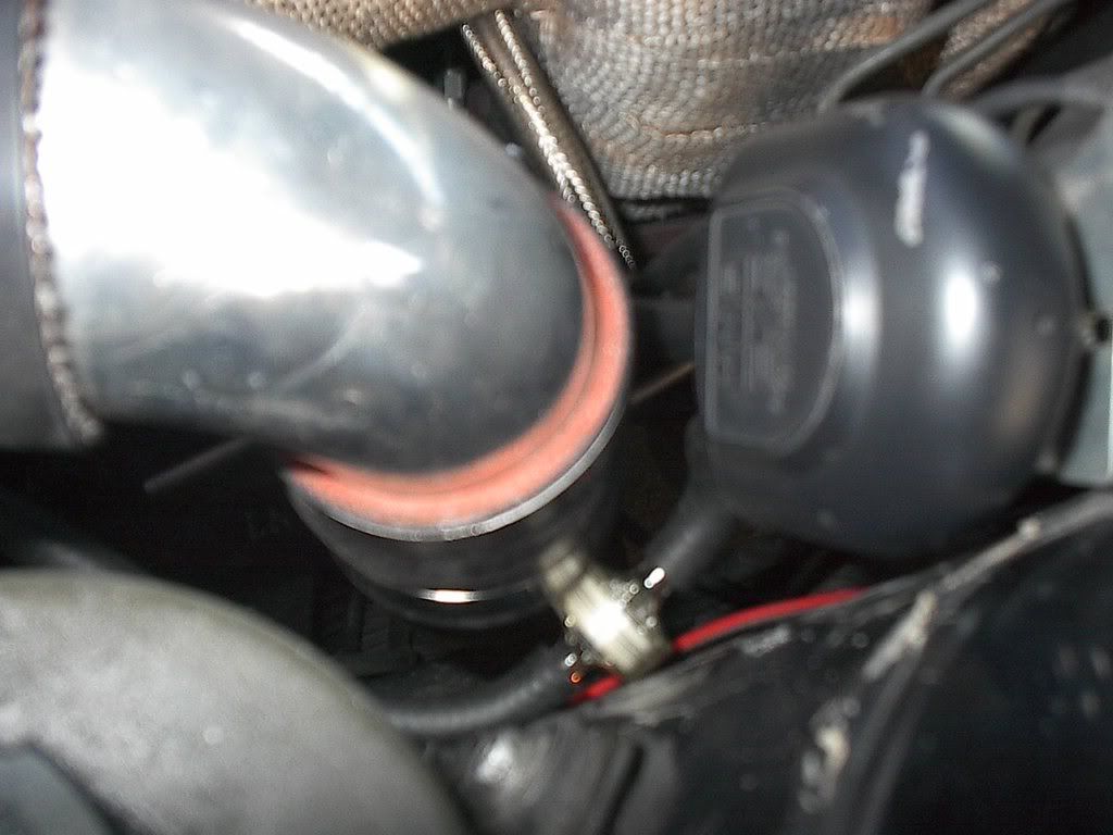

i cant find ANY vacc line problems in the engine bay
hope these pics help

pics are up!
