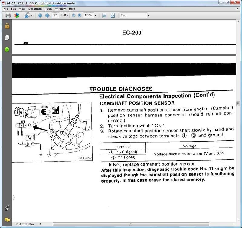

I havent checked my CAS but i have a slightly larger concern after talking to a friend of mine that is a master tech for mercedes.
... make sure you really check everything, i had 3 nissan master techs a stuck on why mine wasnt starting, they all looked right past the cas issue. good luck with the comp issue
