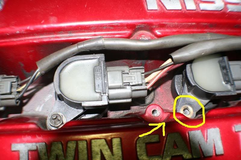

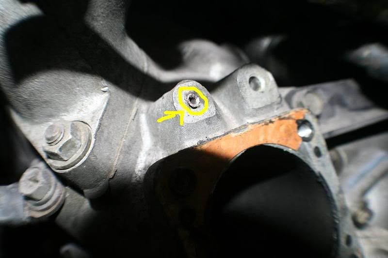

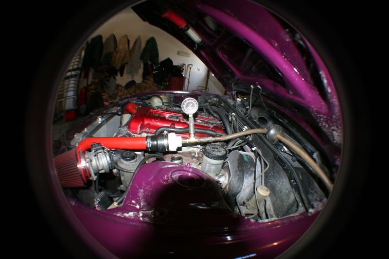

so i just made my own pressure testing device... and i found boost leaks from the bov itself , the flange, the tb gasket, the vacuum ports coming from the intake manifold...and little hoses, so alot of them... and to top it all off, as im writing this messege, my dad comes up and tells me he backed into the side of the car in the garage with the tahoe.... well heres some pics...
in the picture below, the places where i felt a leak coming from are circled... im curious about the one with the arrow going to it though, its all tweaked and such, are those removable? i dont want to break them or something in case they arent..
when i pressurized the system air was going crazy out of that little hole i have circled on the bov?? is something supposed to be there? it seems like thast how it always was?
my little contraption worked quite well

anyone have any advice on these pics?

vutony is close to perfectionvutony is close to perfectionvutony is close to perfectionvutony is close to perfectionvutony is close to perfectionvutony is close to perfectionvutony is close to perfectionvutony is close to perfectionvutony is close to perfectionvutony is close to perfectionvutony is close to perfection
Feedback Score: 145 reviews
plug them up
i have my fpr, bov, boost gauge connected to the tb
as for the vac leak test, i have it capped off to the intake (not hotpipe)

I have mine to the intake as well, works good to catch any leaks on the hotpipe. I ended up getting 2 for in that area.

the bolt on cyl#3 coilpack was broken and i was told that may be a problem due to having a bad ground...?
i got one of the vacuum ports out, but the other broke... drill and remove? or just thread a bolt in to plug it up?
also, the greese on the flange leeds me to beleive that there must be a leak at the flange? anyone have any thoughts on this..
