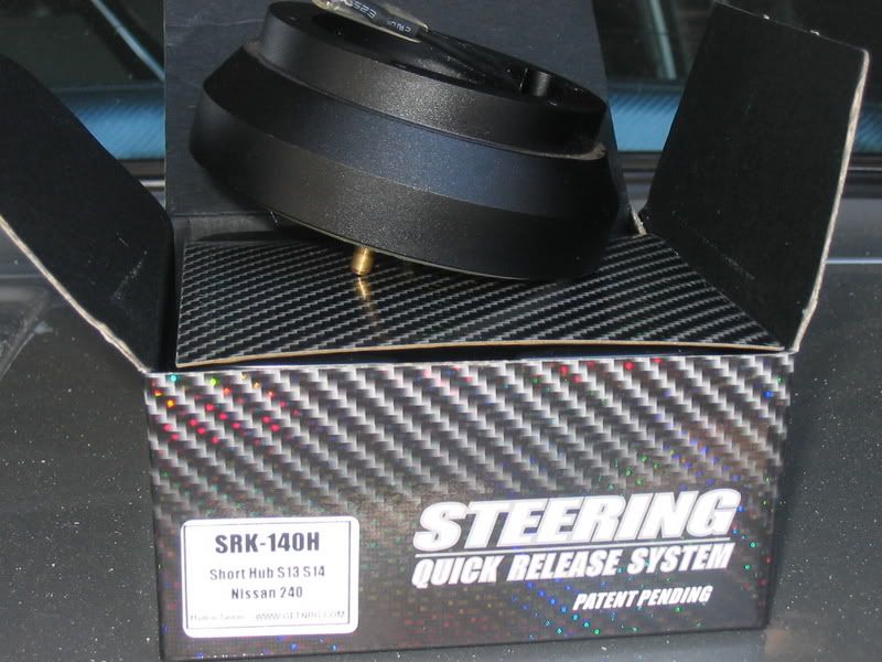

NRG short hub question.. for my s14
i just installed this today.. and well i spoke to someone here and they told me that the 2 metal prongs on the bottom of the hub work for the s14 (and are necessary).. when I installed it, the prongs pretty much didn't touch anything and prevented my holes for the turn signal cancel to touch the hub.. was i suppose to remove the metal prongs? if so how do i take them off? should i just dremmel it off? here is a pic of the prongs.. (i found the pic on the for sale section).. you can see it on the bottom of the hub (gold color).. and you can clearly see on the box that the hub is made for both the s13 and 14.. help guys..
you can slightly see it in this image below as well at the very left bottom (sorry it's not clear, i was taking a pic of my dented hub for some one)..

The hubs are meant to fit both the s13 and s14. Those prongs are meant for the s13. If you use them for your s14 then you will need to break the 2 prongs off.

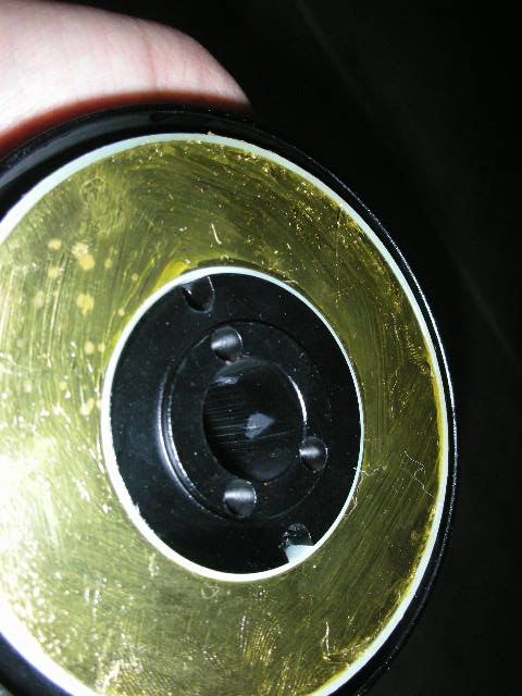

thanks for the quick response.. they are set in there pretty good.. do they screw off? breaking them off would probably dammage the hub.. the only other option would be to cut..

yeah.. i just asked nrg personally since i didnt get a response about cutting the prongs off.. well, they said that i can cut it or try to pry them off.(weird they didnt really know how to remove them). but yes, you will need to remove them to install a nrg short hub onto a s14.. so I fixed mine..
to clarify the turnsignal cancel does work and so does the horn.. the air bag light can be fixed by making a resistor or buying one from mynismo.com.. i just bought one becuase i dont know jack about making one.. i was going to get the works bell boss hub.. but it sits way to close to me.. so the nrg short hub and quick release sits almost in stock position..

apparently the prongs are for s13s.. actually the turn signal cancel works because of the 3 holes on the bottom of the hub.. i didnt use the works bell hub because i felt that the yellow bracket with the plug on it gets in the way and takes up unnecessary space.. the so called "custom wiring isn't hard at all.. you just need to take the wires from the plug near the igntion and re-splice them into the airbag harness.. literally wiring 2 wires together.. well 3 (one for the horn).. you can also re add cruse if you wish.. but mine was removed anyway..

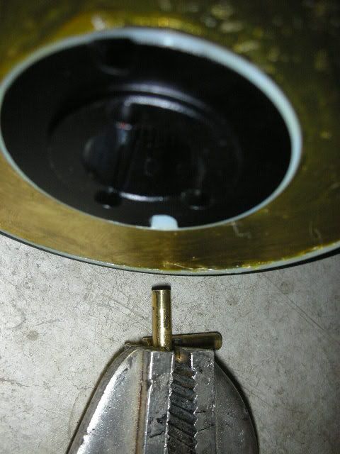

i finally did the install on my s14. just to bump this thread, i found the answer the OP original question.
those prongs do just pop off. just pull them out.. takes lil effort.
