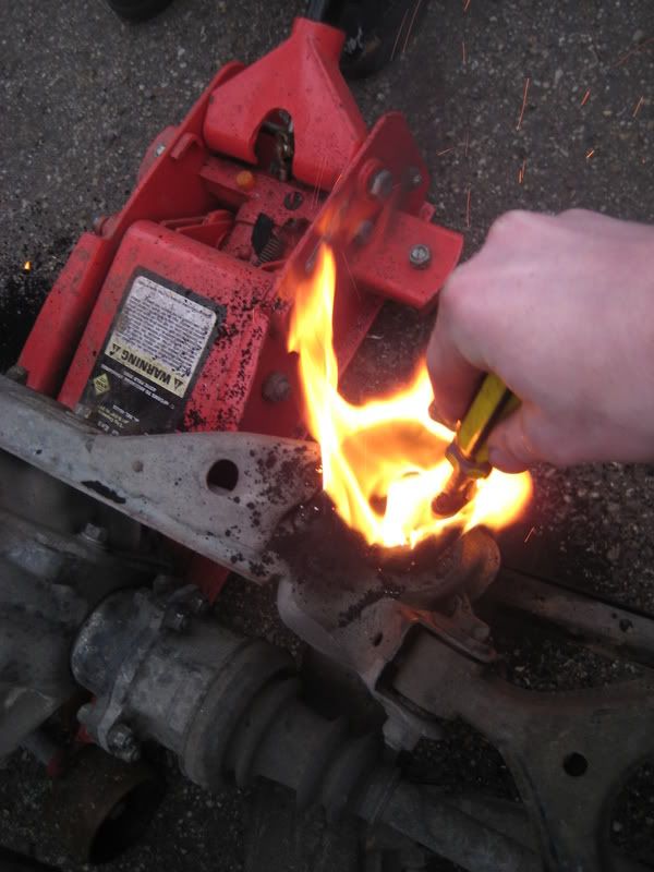

I just installed the SPL's bushings in my car. Let me tell you, it's not exactly fun, except for this part:
But it's well worth it. Makes it much more consistent, with less kickback when you're drifting.

Yeah, I used a HUGE bolt, washers and nut that I used an air gun on to press the bushings in. The bottom ones shed a small layer of themselves as they went in. I didn't have a good torch to heat up the subframe and it was freezing and raining outside. It was a blast!
