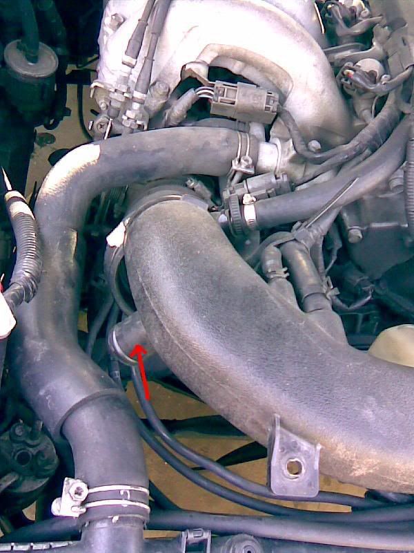

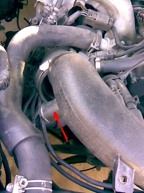

Hey guys, i just got a 240 and i just found a missing hole in the intake. can someone help find where it connects to?

there is suppose to be a black box underneath it. The box is like a resonator. You can just plug it up it wont hurt nothing. Aftermarket intakes dont use it.

^ Exactly what he says. I noticed you don't have your radiator fan shroud that is where it's mounted. You should have that shroud or maybe have electrical fan setup for you may have overheating issue later on. GL!

that opening supposed to go to the stock fan shroud but if u dont have the fan shroud you can always cover it up and u wont have any prob with it.
