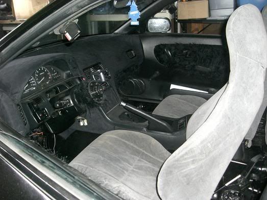

$8 worth of permanent fabric glue, black suede $20 a yard (3 yards) and 1 1/2 hours of meticulousness= That
not counting the gorilla fur on the panels and love box, lol.

that dashboard is so effing sexy
I'm looking to do that as well...

that is exactly what im talking about. that dash reminds me of my old one. have you had any problems with fading? I dyed it back black once but the suede texture didnt stay the same.

Thank you! All I can say is take your time, It looks good, but it could have looked better. If I were to do it again I would have it sewed to the contours instead. I'll post pics of a contour sewn suede fc dash when I finish it.

Good work, but suede gets collects dirt and gets dirty quickly.
